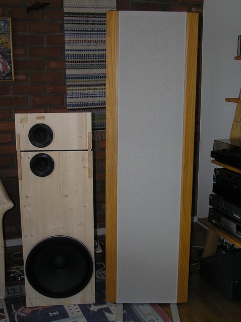

In my opinion it is not placement that is really critical, at least for highbass-midrange-tweeter OBs, but rather room characteristics that matter. An OB will not play at its best in too a dry or damped room, some liveliness must exist. I cannot resist a picture also:
This is 'Volks-OB' MKII playing in comparison with my Magnepan 1.6, guess which one most people prefer ?  :)
I brougth the 'Volks-OB' to DIY-shows in Stockholm and Gothenburg. Stockholm was a big success, Gotenburg less so just because of the room they played in there.
/Erling
