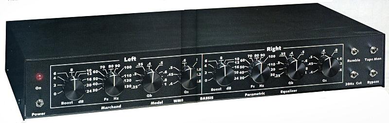

The Marchand Bassis is parametric equalizer that will extend the bass response of a small box and is a DIY alternative to the Behringer.
The April 1990 Audio magazine has a detailed article about the construction, adjustment and use of the Bassis by Ralph E. Gonzalez.
Here is a copy of the article in a pdf file for anyone wanting to build one of these units:
http://www.wghwoodworking.com/audio/bassis.pdf
You can purchase bare boards and parts up to fully assembled units from Marchand.
http://www.marchandelec.com/wm8.html
Wayne
