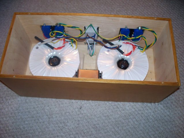

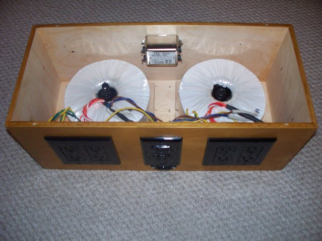

« Reply #11 on: 22 Jul 2008, 07:15 pm »
Here's my implementation of a balanced power conditioner based on two of the Exodus 60V transformers.  I already had the box and outlets put together from a power conditioner project that I abandoned a few years ago.  So dropping the transformers in and wiring them up was pretty simple.  IEC > GFCI > Transformer > Outlet.  Inside the box you can see a corcom filter that I decided not to hook up.
Front Panel
The black AC outlets make it hard to see the front panel, but there are four AC outlets wired to each transformer, a GFCI in the center, and and IEC jack below the GFCI.
Inside
I plugged all my gear into it except power amps, digital gear into one transformer and analog gear into the other. Very nice improvement to the system.  Removed some glare and grunge, lowered the noise floor, brought out more low level detail, improved soundstage width and depth.
My one reservation is that since my line voltage runs pretty consistently around 124VAC, I'm getting nearly 135VAC out of the BP transformers.  Everything I've plugged into it has worked fine at that voltage, though a couple of the regulated linear power supplies I built are running a little warmer than usual.  I'm not plugging any megabuck gear into this so I'm not too worried about it.
So far I'm quite pleased with the results.  Thanks Kevin.
