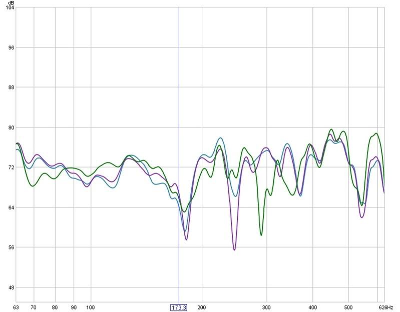

OK a little more info about the room. the room is 16.8 ft long 13.5 ft wide and the ceiling is 10 high at the peak the side wall is 5 ft.  I sit 5' 8" from the back.  Speakers are proac tabeletts and 2 M&K subs.
I have in the room 4 bass panel traps, 2 corner bass traps (4" rock wool with space behind)
For the ceiling I put up 3 - 2 x 4 4" thick traps there is about 14" of space the the peak For first reflections I have 4  2 x 4 traps (2 on each side.
Here is my graph taken using REW and a Radio shack meter
The Green line has only the 4 bass panel traps up. The blue has the corner traps and 2 ceiling traps. the two ceiling traps are locate in front and the center of the room. The purple line is what I got when i put up the last ceiling trap.
As you can see the 2 fregs of 181 and 244  got worse with the addition of the last trap.

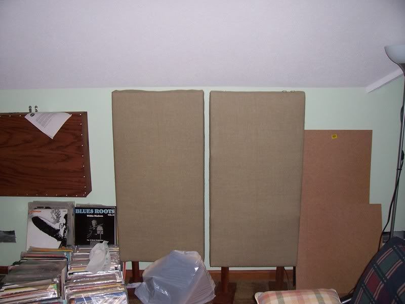

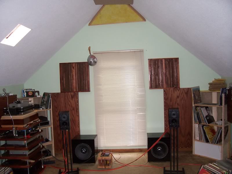

As promised some photo's of my room. Please excuse the mess, We are working on my daughters room so some of her stuff was move in here while it is being completed. I have three photos . The first one is the front view.
On the left and right corners are two bass traps, you can also see two of the four panel bass traps and a tri corner trap.
My stereo rack is on the left. The speakers are 49.5" out from the front and 48" from the sides. The two subs are 25" from the  front and 55" from the sides. I have two record shelves in the corners that I will remove. I am planning on putting them on the opposite wall in line with the stereo rack.
The two diffusers are for slap echo. The slap echo problem was really bad.

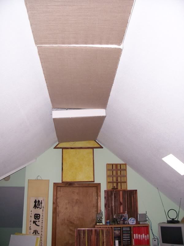

 This is the rear view of my room and the ceiling. There are three traps along the top. The last one is the one that created the dips. They are not completely to against the ceiling yet.  Two diffusers and broad band traps are back there The outcove on the left has a folding door I close while listening
 Here is the rt side of the room with two board band traps. There are 2 on the left also.
Again the side walls are 5 ft and the ceiling peak is 10 ft.
 I hope this gives some more insight into what my room looks like.

Absorbing that peak is the right thing to do.  Generally, when you put up a set of treatments and all of a sudden you get a big null, it's telling you that there was a corresponding peak that was masking this issue.  The null has always been there, it had just been counterbalanced.  If removing just the last panel helps the issue (assuming you can't find out what's causing the null), then that's a small price to pay if you can leave the rest of the peak covered.
