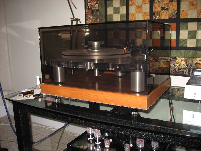

1" Corian Plinth
1" butcher block
bubble wrap (now replaced with cork)
1" butcher block on a sand box (seismic sink)

1" Corian Plinth
1" butcher block
I remember reading somewhere that Corian made an ideal material for a plinth, but for the life of me can't remember why nor can I find where I read it.
I like the feet attached to the plinth. Did you buy the spiked portion like that, or did you have it turned?
BobM
I actually had this made by Larry at Hollywood Sound in Florida, probably 10 years ago now. It uses a VPI MK III platter and bearing and a VPI stand alone motor. I replaced the original Audioquest arm with a Moerch DP-6 and Dynavector 20X-H cartridge. He had a contractor friend who had extra sink cutouts from Corian countertops bond 2 pieces together, cutout the holes and polish it up. The legs are 1" threaded rod that looks too uniform to say it was hand done, so I assume a lathe was used. The nuts are chromed.
Corian is very dead and has almost no ring to it at all. It's heavy and dense, and pretty. All in all I am very satisfied with this little table. It has a lot of life, tons of detail and is very quiet.
Good luck,
Bob
