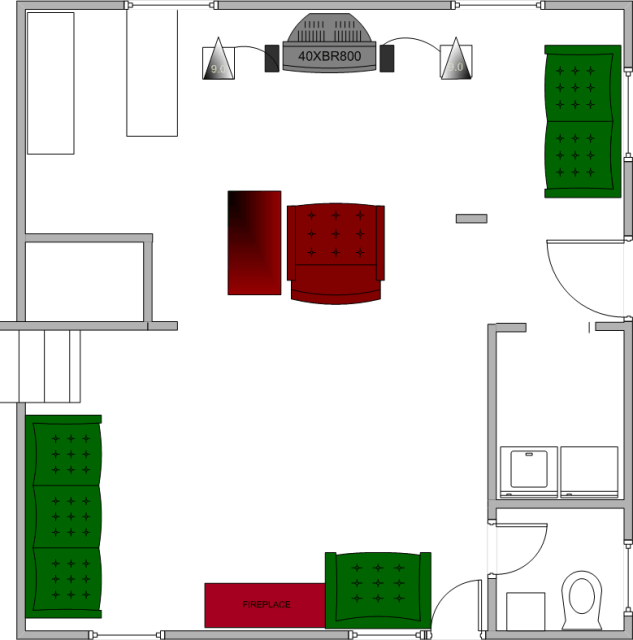

I will measure my room tonight and diagram it.
It is basically a semi-bisected 25ftx25ft room, the lower level of a tri-level house, on a cement slab. But it has some closets (water heater and ducting in one, bathroom in another, and laundry room is an "open" closet.

This is the 25ftx25ft area.
I am considering rotating everything to where the arrow is.
There is a wet bar area to the left, which is open, with a tile floor. The recliner is in the center of the area. At the bottom of the picture in red is a fireplace. The dark triangular shapes are the Marble 9.0s. The stairs on the left lead up 3.5 feet to the mid level of the house - it is open behind the couch.
