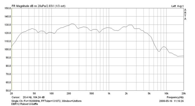

scorpion
Re: MJK's OB Bass study
« Reply #17 on: 15 May 2008, 09:07 pm »
It is just one U-frame with two speakers inside. If you use MJK's models you will se that raising U-s is not any good. Quite another thing with H-baffles.
However good these cheap elements measure, they are not anywhere near the bassunits of my 'Volks-OB' in performance. They may go lower but sounds doesn't match. But they are a very good example that MJK's simulations work. You still have to use good units to get good results. And for a last point of view, I think U-baffles may sound a bit 'boxy', so I do think they should crossovered low.
/Erling
« Last Edit: 15 May 2008, 09:56 pm by scorpion »
scorpion
« Reply #18 on: 16 May 2008, 04:53 pm »
Graham,
I put it up on the small side and measured. It is no great difference. I would have expected more. It does sound guite decent up in the frequencies but a bit closed in upwards and boxy. I suppose that my comment of 'boxy' earlier came from this extended response. However with regard to bass presentation they are not in anyway near the performance of the A&D 1524 units of my 'Volks-Ob' regarding speed, distinction and presentation.
But with small means you can do wonders for budget speakers.
/Erling
Rudolf
« Reply #19 on: 16 May 2008, 11:04 pm »
Erling,
the BR 12 are the drivers from the "venetian blinds", right?
If your last measurement is done at the same 1 m distance as the first (and possibly 15 cm above the floor too?), it can´t tell the truth. With such large geometries you have to measure WAY back (listening position?) to detect differencies in the bass performance with some validity. I have seen that with own measurements before.
IMHO the most notable effect of floor mounted drivers is the absence of a delayed floor reflection. Raising the driver 16" will distort the frequency response much more than it will lower the bass level:
The sim is with the original MJK U-frame worksheet data with the Eminence 15A. I only doubled the heigth of the U-frame (red) and moved the driver 16" up from its bottom position (purple).
This seems in line with your measurements where the most noticeable SPL differencies are in the 300-2kHz region and not below 200 Hz.
