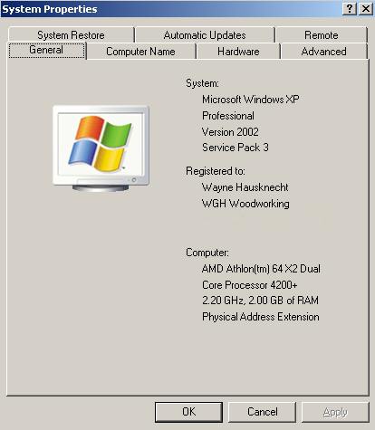

Um...how do I know if I have sp3?  I have it set to auto update.

WGH
Re: Windows XP Service Pack 3
« Reply #28 on: 22 May 2008, 12:45 am »
Right click on "My Computer"
Choose "Properties"
You will see this:
Yes it is now available by Microsoft Updates, that is how I got mine.
Auto Updates is probably phased in, but you have to manually click the "OK" button a couple of times to install.
Allow about 45 minutes, this is a big download and install.
