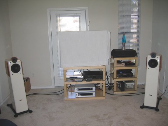

I've been working on these for a few months and have finally gotten them to a point at which i'm really happy, so it's time to post. I'll start with some pictures of the design
These were intended, and i feel succeeded,as upgrades from a set of custom dipoles i had Rick at Selah Audio design for me a few years ago employing Accuton, Seas, and BG drivers. I wanted something that had a similar tonality, smooth and neutral, but with better dynamics, high spl ability, higher efficiency, and a smoother power response. On top of those goals, the design needed to be kept slim and decor friendly --the base is 17"x11", overall height is 48", and the baffle tapers from 12" down to 15".
I chose to use the pro-sound Radian 5208 coaxial driver for the mid/tweeter (chosen for efficiency and coax design for better power response) and 4 x GR Research M165X (good parameters for OB, high enough sensitivity with 4 of them, and maintains slim baffle) per channel. As can be seen in the photos, the Radian is on a flat baffle and the 165s are in a shallow, tapered, stuffed u-frame. Crossovers are done actively with a BBE DS48 crossover and are all acoustic LR4: 1.5 kHz between the mid/tweeter, 250 Hz for the mid/woofer, and 75 Hz for the woofer/subwoofer. I have a 12 ohm resistor and .33 mH inductor forming a shelving filter to achieve the initial roll-off of the tweeter, match levels between the mid/tweeter better, and provide protection in the case of component failure. It also helps to keep down some of the noise from the active crossover with a >100 dB efficient driver.
So, on to the objective
First, some gated measurements at ~33" taken with Arta, a Behringer ECM-8000 mic, and a M-Audio Mobile Pre sound card
NOTE: UPDATED MEASUREMENTS ON PAGE THREE
On the intended listening axis (30 degrees off-axis) with minimal 1/12 octave smoothing. If you think it looks jagged, notice the range (35 dB) of the graph. The response is +/- 2 dB from 400-15 kHz if the (diffraction?) nulls at 8.5 and 11kHz are smoothed over
Next, the response from 0-60 degrees off-axis, also gated. This time i used more conventional smoothing (1/3) and y-axis range (50dB). The response falls in the same +/- 3 dB window from 400-15kHz and 0-30 degrees. Even out at 60 degrees, the response is smooth and even up to 9kHz. Aside from the 1.5 and 7.5kHz regions, i'm really happy with the response.
Now, a 1/3 octave smoothed response at the listening position. That's +/-3 dB from 10 Hz - 15 kHz
Finally, some distortion measurements. This was measured on-axis ~ 7" from the baffle. 0 dB on the graph corresponds to ~100 dB at 1m, c-weighted. I don't have a lot of faith in this measurement, but i did the measurement and figured i may as well post it.
Subjectively, i'm very happy with the design. I feel that i accomplished all of the goals i set for the design. Is it perfect? No, of course not. I'd like to see a more well controlled power response, and the radian compression driver is a little on the cold/sterile side and a bit sibilant --both treated as well as possible in the crossover/eq but still noticeable. Having speakers that can produce >100 dB without breaking a sweat and needing very little power is pretty impressive. This aspect is the most noticeable improvement over my previous speakers.
Also, for those that doubt the abilities of pro-sound drivers and horns, let me say that they can sound fantastic if treated well --just the same as any driver. Well designed horn/waveguides do not honk or have the horn coloration i, and i'm sure others, associate with many of the horns around.

Jason, looking good!  Good work and congratulations on your full OB baby!  I'd like to hear them - Mark H probably would too - maybe one of these days we could meet at your place for a listen - I could bring my Chinese tube amp for grins.
Should I reveal your secret?  That supposedly ordinary blanket draped over your TV, which is in reality woven from a specific acoustic absorption coeffecient fiber aa
gitarretyp
Re: Radian & GR Research OB Project
« Reply #11 on: 6 May 2008, 04:49 pm »
I'd be happy to have you guys over. As things are setup, i could only use the tube amp on the mids. But, that could still be interesting.
No one was supposed to know that about the blanket :evil:. Now everyone's going to be clamoring to get one.
