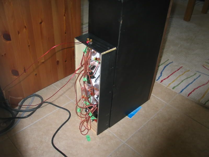

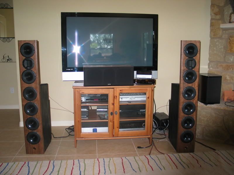

I was able to finish these up over the weekend.
I did the crossover externally and might attach to the back of speaker to keep down the rats nest down that I already have going:(  Thinking of putting plexiglass as a cover.

I am very happy with appearance, and dont really miss my commericial speakers at all. I am still putting some hrs on them but I am very pleased with the sound. They are very easy to listen to and I dont experience any fatique which I had occasionally with my other speakers. They are very resolving and demand a good source, but you are richly rewarded. I would say and agree with Bill that the bass is amazing. I have been listening to them mostly without a sub cause the bass is very clean and tight. I have the bass management system on my circut board but not employed yet during evaluation. I have a very large room and I think the rolloff might be ok without bass management. They are a step above my former speakers in almost every respect.

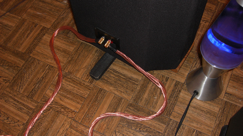

I am still breaking in the OB-7's and enjoying them more and more. I have a question about speaker wire on a budget. I had tried a pair of anti-cables and although the detail was good I found them leaning toward bright. I have switched back to my Canair star quad wires but feel I have lost some detail. I am wondering what every one else has found? Any budget reccomendations?
You could do what I did and make your own out of standard multi-strand 16awg wire. I'm using 4 x 16awg per (+) and (-) of each speaker. Each side somes out to 10awg. For a 26' run, one side of the cable measures only 0.09 ohms on my HP 3435A MM at the spades! They are just a basic loose twist, but done by hand and took all of 5 hours to do (had to do it 4 times total). The cables are terminated with heavy duty spades and finished off with heat shrink. The bass is tighter, the treble is smoother and the overall sound is stronger sounding. Kind of hard to explain. These are the best sounding cables I've used to date, including Kimber 8TC, Space & Time, MIT, and several other overpriced cables.
Anyway, here's a few pics of the cables...
