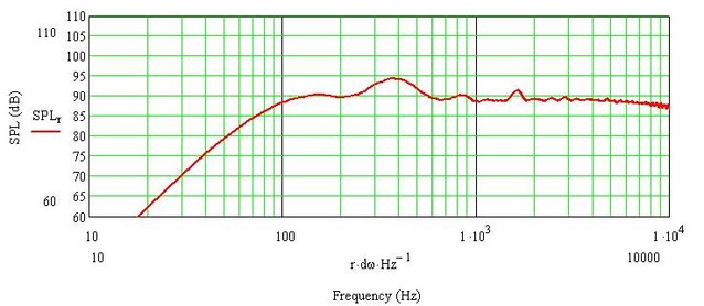

Here is a simulation with MJK's Math Cad models of your basspeaker in an OB 40 x 40 inches. I suggest you build this like MJK's in his project 7  Lowther Open Baffle System (16 " wide main baffle and two 12 " wings 90 degrees to the main baffle). Speaker was placed 30 " high and 4 " off center. You should have no problem compensating for the bass roll off and sensitivity should match the tweeters. I haven't ordered Jan Diddens kit yet, but I probably will.
/Erling

Thanks for all the input. Since this is just a first effort I'm going to give Erling's suggestion a go. I made a lot of sawdust on Saturday and cut all the panels. I will cut the holes and get the hinges mounted this weekend (hopefully) and get them up and running. I'm looking forward to it.
