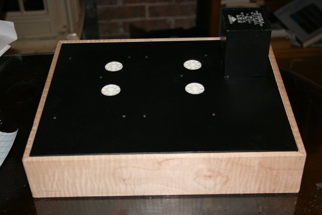

Dry fitting the Aikido chassis.

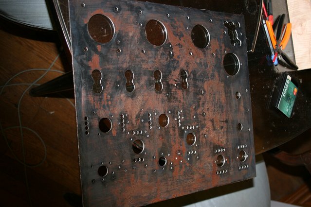

just when I thought I had it done, the patina that is, this is what happened, my failed attempt at patina'ing the UBM.  It flaked in places, which actually came off with blowing on the chassis, and exposed a more copper color.  It looks cool in a really distressed sort of way, but I am thinking about buffing it out and trying again.
JoshK
Re: Proof of existence...
« Reply #32 on: 20 Jul 2008, 07:03 pm »
The patinaed plate is really hard to photograph and doesn't look quite like that in person.  It looks a bit nicer in person, but still pretty wild.
