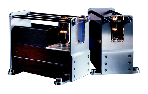

    Seem like you will be looking at big Triode tube for this job. And Scott already mentioned the Opera 845. There are a few more that I could think off...
    deHavilland  845 and KR Audio Antares VA 320.
    The KR Audio use it own 842VHD tubes the same tube that I have in my Welborne Lab "Apollo" putting out about 18 watts per channel :D I used to use these amps to drive Magnepan 1.5 more than loud enough for me in my small room but not to concert level. :D This is not your grandpa's SET tube. :D

   With 82dB sensitivity it is a bit tough to find a true SET amp for them.
   Yes, Quicksilver make amp based on 6550/KT88 in SE mode. And they are not the only one. Audio Note Kit also have a kit like this. But you will still get power about the same as 300B... 8 to 12 watts. I have heard many years ago that KT88 tube make a great SE amp. And I was looking into this type of amp before I decided to go with my current amps. :D If you can live with this low power than these could be a good alternative choice to the true SET amp like 300B since it won't cost you an arm or leg to replace those tubes :D
   I've heard the KR VA320 in my own system compared to my own amp using the same tube and they are both sound very close to each other. The KR VA320 seem to have a bit tighter bass and a bit quieter but mine are smoother and more dimensional I would say. :D The biggest difference is that the KR VA320 use transistor input stage but mine use all tube. And there is nothing tubey about these two amps. :D
  Anyway, with those speaker it would be tough. I think you need to establish of how much power you could really live with. Maybe if possible you could borrow a few amps to try? Good luck. :D
