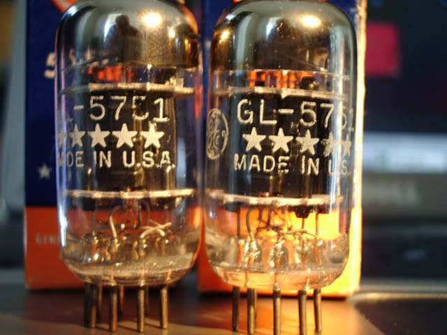

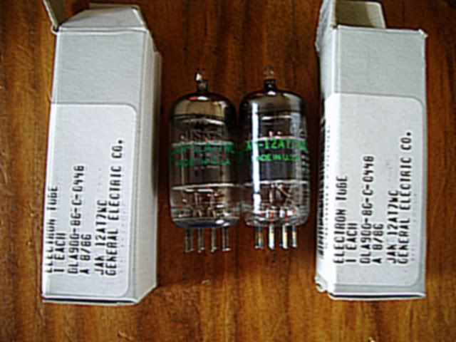

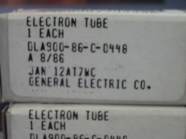

I got em. Think it was a good deal too  :D.
The 5751's measured 128/128 and 136/136 so close to 5% matching I guess. Will this matter in a pre amp section? The 12at7wc measure 126/128 and 130/128. I still don't really know what these numbers mean  :lol:
Here's some pics
I'll see how they sound soon. If I don't like them anyone wana trade something?

After looking at some pics I think these are gray plates? They are GL-5751's. Some places are calling them black plate, others gray. They look black.
edit: tube world had me confused, they posted a pic next to a gray plate for comparison. I though they were showing only gray plate. They're black I guess.
