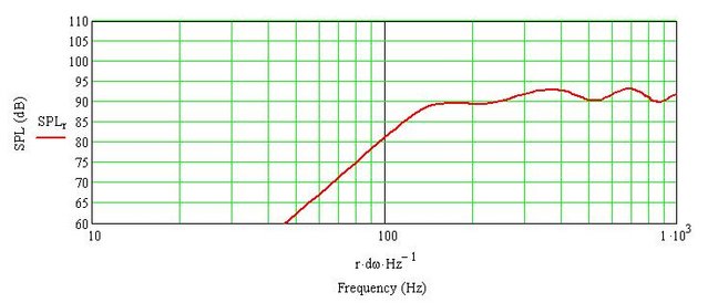

Here is a simulation with Martin J Kings Math-Cad  models: http://www.quarter-wave.com/ of Monacor Fullranger SP-130/X8 which I use in my 'Volks-OB': http://www.audiocircle.com/index.php?topic=46951.0 . Element on a baffle 100 cm high and 40 cm wide, element center situated 85 cm up the baffle and 15 cm in from the side:
As you can see there will be baffle support down to about 150 hz. I have however chosen to crossover at 300 hz to have on average a little better efficiency and above all much better
power handling. You will face trial and error or simulate with a good simulation programme.
