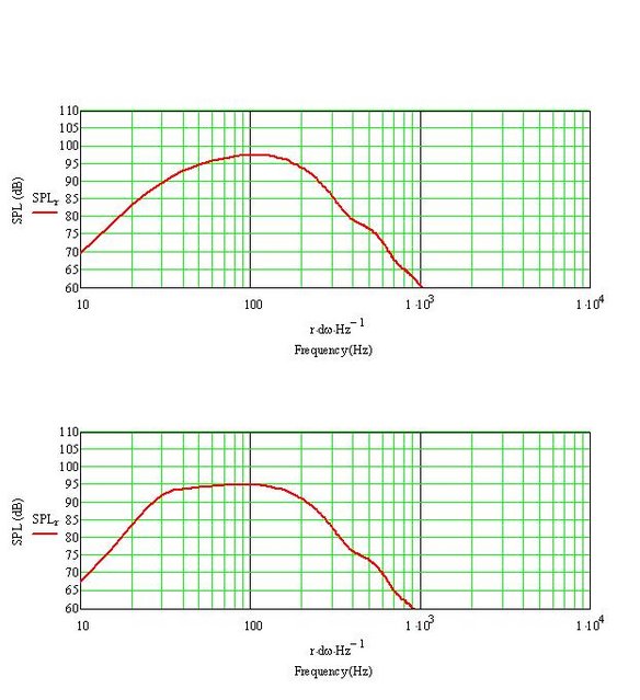

Hear are two simulations of Warrior 18 with Martin J King's MathCad models.
Both are taken on an OB 54 inches wide and 24 inches high (could also include wings), the element is situated in the middke of the baffle with center 10 inches above floor. Element is crossed over low-pass at 150 Hz 2nd order Linkwitz-Riley.
The first simu is with element as is, the second with altered Qes to give a Qts value of 1.35 and a lower Bl-factor accomplished with a 6 ohm resistor in series with the speaker.
Impulse responses are identical. I think the adjusted Warrior would mate perfectly with B200 high-passed at 200 Hz. Simus (1 watt power) speak for themselves:
/Erling
