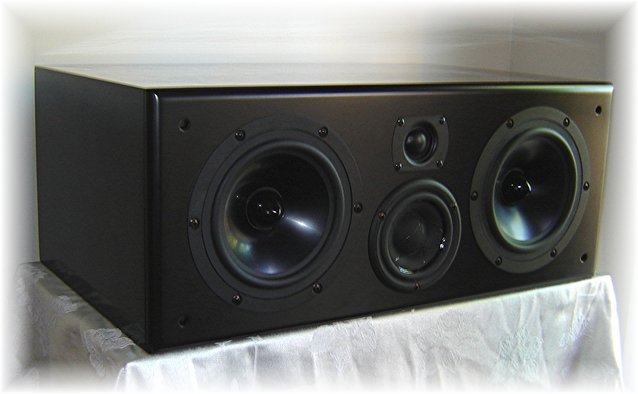

Pictures and details coming soon for a SSR/Galena matching center channel, the SS3CC.  :thumb:

Cacophonix
Re: Reference Center Channel
« Reply #3 on: 12 Feb 2008, 12:48 am »
Wow .. that looks huge!
Am sure that it'll sound awesome!  :thumb: :thumb:
Any slim center channel in the works for us apartment dwellers?  :wink:

Hey Rick... nice combo :D. I bet it would look amazing in one of your veneers.
Have you considered a 3 way with the same speakers but in a tower? If the two W's were ported, how low would they extend? 40 Hz? Sealed? 50 Hz?
Here's a smaller alternative :
Rick Craig
  • Posts: 3680
  • Selah Audio
    • http://www.selahaudio.com
« Reply #6 on: 13 Feb 2008, 12:53 am »
Sure we could do that. With a tuning like the SSR it would have the same anechoic / nearfield response, -3db @45hz and -10db@33hz. Sealed is -3db @64hz and -10db @48hz in this design. If you port several in an array they magically become -3db@18hz in-room according to the "optimistic" claims by other designers  :scratch: :lol: :lol: :lol:

Rick,
What drivers are in the smaller center channel?
Thanks
Todd

How would SS3CC compare to vertical (angled) ssr in the center?

Rick,
Thanks
Todd
Dayton RS180 woofers, Scan-Speak midrange, and Vifa tweeter.
If you keep the SSR in the vertical position and can locate it on-axis with your listening height you'll be fine. The SS3CC is for situations where the cabinet height is restricted and adds the outer woofers to increase the output capability  (versus only using the 5" as a woofer in a 2-way). The smaller midbass also slightly increases the vertical listening window in case the center isn't right at ear level.

Rick, very curious as to the dimensions/specifications of this seriously robust-looking center channel. 8)
24" wide by 12" high and 12" deep. The sealed box is -3db @ 64hz and -10db @ 48hz. Impedance is 5 ohms. Drivers are dual 7" Scan-Speak Revelators, 5" Revelator midbass, and Fountek ribbon tweeter.
