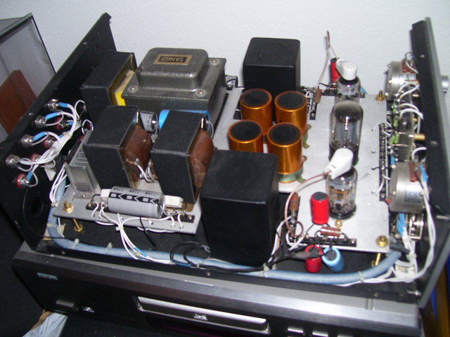

thanks everyone - tanchiro, what's that beast on your pic?

tanchiro58
That is a SET preamp using 5u4 rectifier tube and 8608/8233 output tubes. It weights 30-40 lbs (do you see chokes and Tango tranny?) and has double C-core output trannies with 46dB output. Good luck in the search.
