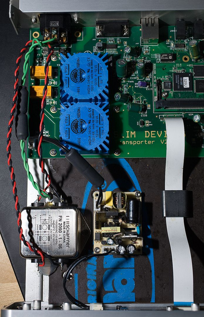

alekz
  • Posts: 11
Re: Mauimodded Transporter and sibilants
« Reply #14 on: 20 Jan 2008, 06:10 pm »
The ferrites on the ground wires are supposed to filter the noise out of them. The current is nihil. The setup is differential: the ground wire from the socket goes through the ring to the line filter, then from the line filter through the same ring to the power supply.
There are no rings on the audio phase/neutral wires.
It's easier with pictures:
Modded Transporter (PS) 800KB:
Stock Transporter: http://photos.lam.ws/gallery/1930618/2/98101199/Large
« Last Edit: 20 Jan 2008, 10:27 pm by alekz »

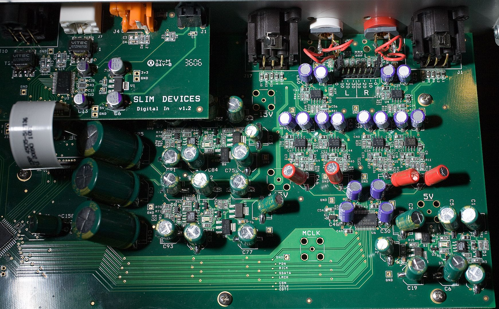

alekz
  • Posts: 11
« Reply #16 on: 20 Jan 2008, 09:30 pm »
Now the DAC and the analogue part (you can see 4 Black Gates) 900KB:
