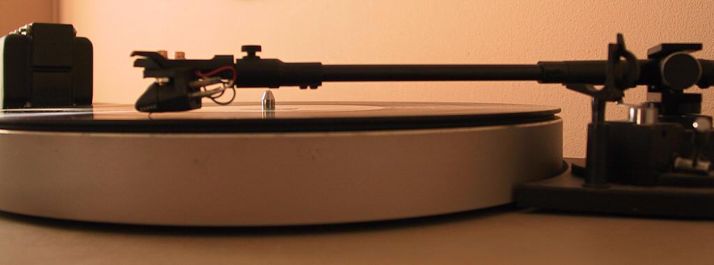

Here it is as supplied from the Factory:
Here it is, raised as far as it will go:

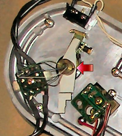

Just loosen this screw at the back of the arm, raise and re-tighten:
I see a hex screw at the rear of the T55 arm, but loosening it did not allow the arm to be raised.   I know WGH said he adjusted the VTA on his T55...how do ya do it on that table, Wayne?

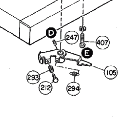

Raising the arm on the T55C is a little more complicated, but it can be done.
1.) Download the T55 Technical Service Manual from Vinyl Engine
     http://www.vinylengine.com/library/harmon-kardon/t55.shtml
2.) There is a setscrew in the back of the arm column base, you can loosen it with an allen wrench but the arm won't move yet.
3.) Inside the table there is a couple (I think) of very tiny allen screws that hold the autolift arm in place, #247 in the drawing, buy a selection of the smallest allen wrenches Ace Hardware sells, one of them should fit. Once these are loosened the arm will fall out, so be careful.
4.) The base setscrew (#2) holds the arm at whatever height you need, then the autolift arm has to be re-set and tightened so the arm lifts at just the right point at the end of the record, this is usually done by trial and error. The service manual (#1) explains the adjustments in detail.
5.) You will notice that the arm rest will no longer pick up the arm at the end of a record, this is because it is now too low. There is no height adjustment that I have found for the arm rest, so I added a rubber tube over the arm to make it higher. You can just see it in the photo below.
Your cartridge body should now be parallel with the platter.

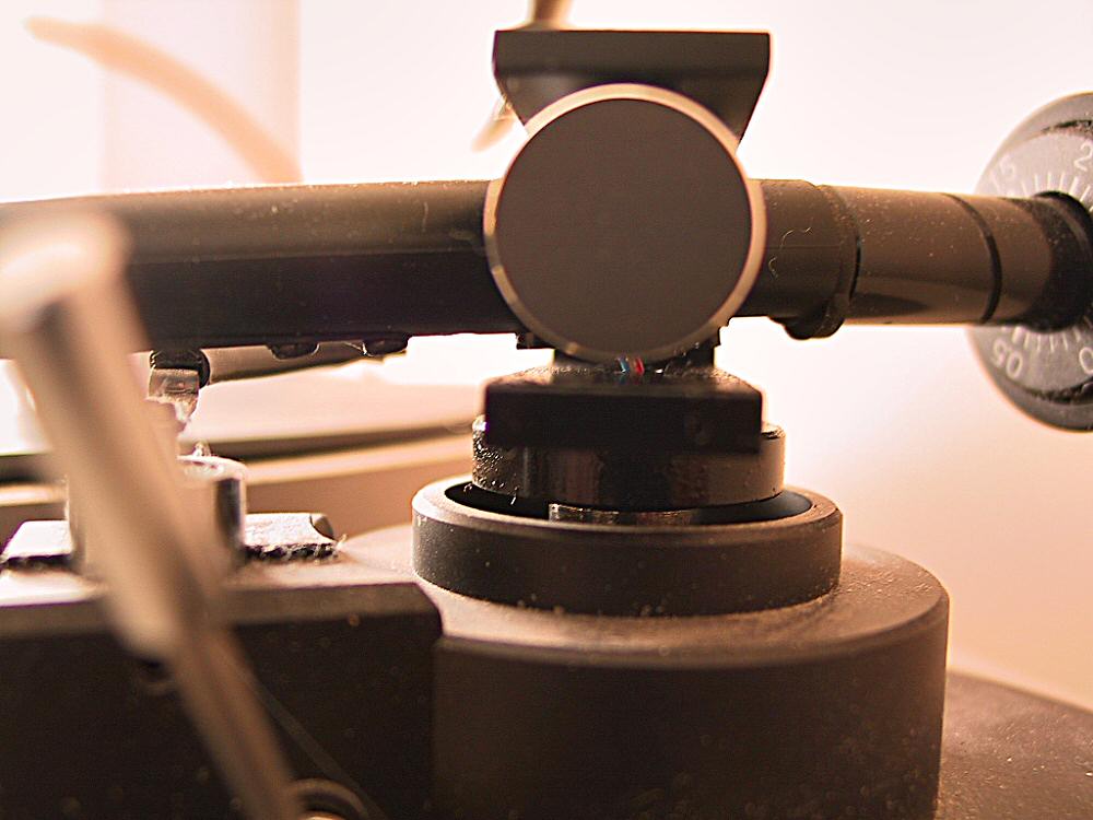

What part of the cartridge body is parrallel to the record surface? The top, I hope. That probably is the only reference surface on any cartridge. That should equate to a parallel arm tube to the record surface (if the arm tube is not tapered). To determine if the arm tube is tapered, you may see that it is smaller in diameter by the headshell than it is by the pivot assembly. Most straignt tone arms are made out of tube that has a uniform diameter from end to end. one example of an arm that is not is a Rega. They are cast and have a taper down the entire lenght. If you align the top surface of the arm to the record, you will be off by the taper amount, less the cartridges rake angle.
If your top picture of the pivot assembly has the stylus on the record when you took the picture, you have a problem.

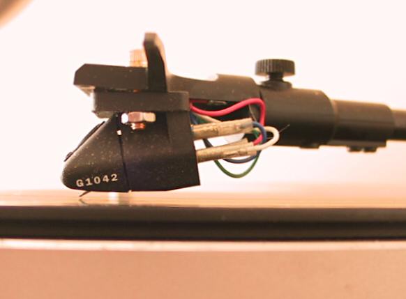

Yes, Wayner you are correct, the arm tube should be parallel to the record surface with the needle on a record.
The Goldring G1042 directions specify the cartridge bottom should be parallel with the record, if the arm is parallel then it all should fall into place and be a good starting point to fine tune the VTA.
Here is a better photo of my setup.

Oh good, beautiful! Nothing gets me going more than perfect geometry! I thought you had done your homework!

I am eyeballing the T25, and I see that with the Arm in the LOWEST position, that the arm is ever so slightly tilted downward at the cartridge end.
What do you do in that case???
Jazz-Vinyl
Re: The HK T25 has VTA Adjustment!!
« Reply #9 on: 29 Dec 2007, 12:19 am »
Ah!  Play around with a very thin mat if the VTA won't go any lower..?

If you need to raise the front of the arm so the arm is level, then you will need a spacer between the cartridge and the head shell. I have heard about them but don't know where to get them. I think spacers are supplied with the Denon DL-1xx cartridges.
Being a woodworker, I would make a spacer out of a musical wood, or a dense wood, or whatever I had laying around.
A thicker mat will work, but that can get very expensive very fast, the mats will end up costing more than the table.

I went out to the garage and snatched the Mat off the Technics SL-Q2, placed on top of the thin HK Mat...and - it worked perfectly!   Cleaned up the T25's bass.  It's soundin' GOOD over here!!!

Here is my VTA Geometry (this is the LOWEST setting):
Audio Technica 216E = L/R Balance 1kHz < 1db
Stylus Tip - Nude BiRadial (0.2 x 0.7mil)
Cantilever - Thin Wall Alloy Tube
Compliance = ?
VTF - 1.0-1.5gm (I run at 1.25 grams)
