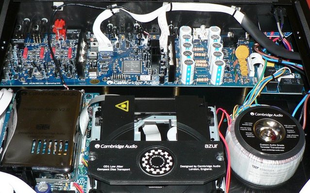

Another interesting product along similar lines is the Anagram up-samplers to 384K implemented on the new Cambridge Audio's CDP's:
http://www.cambridgeaudio.com/product_reviews.php?PID=272&Title=Press+reviews
They evidently kill anything near its price point.  I have got 'itchy' fingers to get one of these and have mods done on it.  I understand why high quality caps etc like BG's are not used in a product like this, but why they have these complex output stages with a number of medium quality op-amps and associated circuitry is beyond me.  For voltage output DAC's direct coupling using a high quality cap would seem ideal.  For current output DAC's a simple transistor or FET class A I/V converter looks the goods.
I have a Cambridge 840C and it's ripper. Like a LF55 the sound quality sneaks up and you have to live with it for a while to appreciate it. If you want to be wowed and impress your mates, forget about it as it's a music maker pure and simple.... doesn't tart up the sound or add the warm fuzzies. This player is a winner on all counts and has a bonus of being a DAC for 2 other devices.... bargain of the year.
Caps are not an issue with this player as there are none in the signal path. I'm not going to argue about the quantity of OPA2134 op amps in there (there are a few) but the output has a very low impedance (<50R) which can only be achieved by a good buffer on the output AFAIK. They have Doug Self on board so I imagine it's all done for a reason.
I thought the output impedance would be low enough for a passive pre but still sounded better using a Burson Buffer.... great gadget.
CD tracking is very good considering it uses a crappy Sanyo drive and laser. Doesn't go through my torture CD like the Sony CDP-X55ES with the great KSS-270A laser and linear drive but does 75% of the tracks which is admirable. Most CD players only do 20% of the tracks.
Great to know.
I am thnking about going the whole hog and getting the Burson pre.
To me the CD player is just a bonus.  I was gong to feed it from a Squeezebox anyway.
I was thinking of the 740C.  Do you know anything about its output?  I was thinking of getting its clock and power supply modded but ripping the output buffer out and replacing it with a simple cap (the DAC in the 740C is a voltage out DAC).  The other option is a Burson discrete op-amp.  Any thoughts?
I thought the outputs would be very similar. Discrete op amp might be an issue as it's all SMD's in there and from experience the Burson op amps need higher voltages to be at their best..... 18V - 24V. Just adding the external buffer yields better results IMO.
Before thinking about modding, have a look at the inside as it's SMD city. The power supply is quite good as there are over 18 supplies in there. May be better off with a dedicated DAC.
The other option some modders use is an output transformer.
