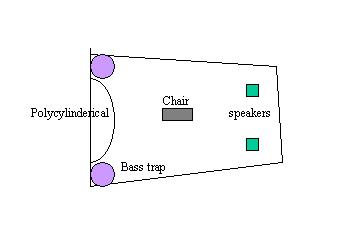

Bryan, you mean something like this is good enough..?

That's basically it but the front wall would be parallel to the original back wall.  The thing is there won't be much of anything left of the rear wall by the time you do the diffusor and the broadband.
If the room is wide enough to make a single poly impractical in the rear (and it likely will be), then you can make one about 8' wide and fill the gap between it's sides and the broadband absorbers with a series of well diffusors.
For a better look, instead of tubes, think solid chunks of absorbtion (triangles) going side wall to back wall.  Those will reach a LOT deeper than any resonably sized tube and take up a ton less space.
Bryan
