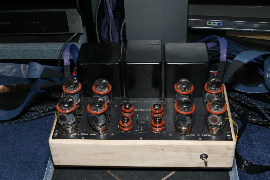

For those interested-I changed the wooden cabinet to a dovetail 3/4" maple wood with a solid oak bottom for a MAJOR increase in sound quality.Any one want photos?

 :D Here are photos of my maple cabinet using box joints I built about 3 years ago.I was learning how to use my router and made different joints .I also have an oak cabinet for another RM-9 but one of the output transformers is cooked.I will be replacing it soon.The amp is floating on marbles which is sandwiched between 2 Home Depot cabinet door knobs(home made roller blocks),sitting on a sandbox that weighs about 50 lbs.The amp is really clear and clean with excellent isolation from vibration.I then isolated each foot print on the plinth by cutting it into a diamond shape to dissipate any amp vibration. What do you think guys?The tube damping rings are teflon and really cut down on microphonics(came from ebay).The yellow wire is my bias adjustment for the Tungsol 6550's.

Roger-how do you like the cabinet ?Any comments?

When it comes to wood, to each his own. My desire was to have a very low rise on the frame which took some doing.
