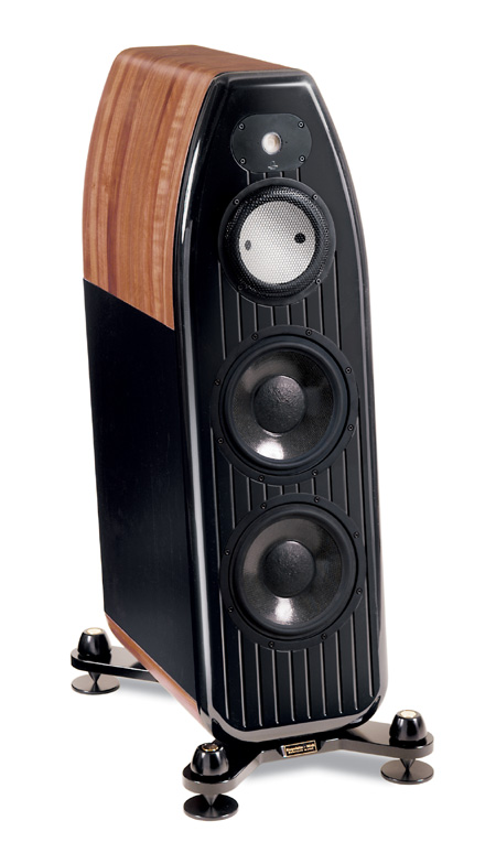

Jim,
  I wonder, what does it take to make the top a smoother curve like this:
( No..I don't mean to suggest that you copy the Kharma... just a picture to illustrate what I mean)
Rgds
barry
jsalk
Re: Bill's birds eye maple HT3's, HTC and stand
« Reply #10 on: 30 Nov 2007, 03:13 pm »
Jim,
Rgds
barry
Barry -
If you notice the bottom of the cabinet, it is curved as well.
The way this is usually done is called, among other things, translamination.  Imagine a piece of 3/4" or 1" mdf cut in the shape of the cabinet.  Now duplicate this and cut out the internal section of the piece to duplicate the internal dimensions of the cabinet. Duplicate this many times and finally cut another piece just like the first.  Now stack all of them one on top of the other and glue them together.
Using this technique, you can create virually any cabinet shape with any internal shape you want including all bracing.
Since the pieces need to be exact, they are normally all cut with CNC or pin routers with templates.
This is something we may try with some future model.
- Jim
