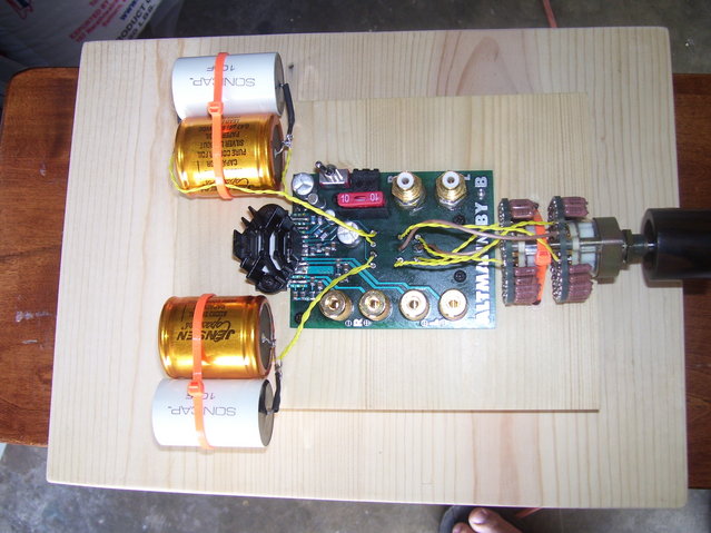

My BYOB amp had high gain to and I just replaced the stock volume pod(10K) with a Goldpoint 100K stepped attenuator. Now I am able to crank up the volume to 12 o'clock without the irritation of loudness (high pitch). The solution of changing speakers does not sound good to me since you have to spend more money. The stepped attenuator costs only $150-$200. However, that is your choice. Good luck.
Tan, nice work!  Pity I've no DIY skills. So changing the volume pot is a non starter for me.  Btw. I'm not thinking of changing to new speakers to solve this problem.  What wanted to say is that I perhaps one day I would like to try others speakers but I would like to keep the high gain version of the BYOB I have now. So Charles solution and the step attenuator between the Dac & Amp would allow this.

I did really replace the stock 10K volume pod in my BYOB amp with a goldpoint 100k stepped attenuator and it comes out an excellent result. The BYOB amp sounds more lively from the position of 9 o'clock to 2 o'clock like Goldpoint suggested. :thumb:
Tan
Tan
