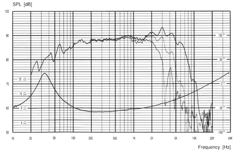

I use Odyssey Lorelei's with a Scan Speak 8545 driver and the port plugged to cut the cabinet interaction. Here's a frequency chart of the driver.
With my Sunfire Theater grand 4 processor, I have the Lorelei  frequncy cut at 80hz so the 70hz drop that the graph shows is being bypassed. I use the 20hz inputs on the Force and have them both set at 80hz that in my thinking would be filling the 70hz dip of the scan speak driver. I have the sub on a 26" sub stand that's placed up front, next to and on the inside of my right Lorelei so the phase is 0. To my ear, it sounds pretty damn good & fast w/o being centalized, in other words it's blending well with the mains. As it is, the Force hids itself better than the front firing Cerwin vega, Velodoyne, or Adire subwoofers that I've previously owned. My room is heavily treated 11 x 17' and I'm only concerned about the sweat spot, not the whole room so I take my test tone readings from this one spot. Using the rumbling test tone of my Sunfire, I'm seting the Force at about 4hz over at the peaks of the 6.0 system.

You need to consider what the speakers are doing in the that cabinet in that room rather than the raw driver data.  If you can get the Lorelei's to work smoothly down lower in your room, I'd cross the sub over a little lower.  The Lorelei's have a nice bottom end as long as it's not a huge room.

But then again, I've plugged the portholes so that bottom end won't be there. Let's face it, that low end isn't coming from the drivers, it's coming from the cabinet and it's being directed from behind the mains. The subwoofer on other hand is right up front with the mains and it's sealed cabinet bass is being radiated thruout the room. There's really no contest which is throwing out the tighter lower bass. But I see what you're saying about that chart, it's not relevent to it's application. So much for my thought process there.  :scratch:
