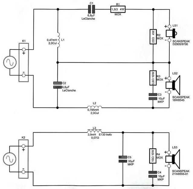

Hi there, I am looking for some advice from those of you who are familiar with the Scan Speak D2905/9700 tweeter used with the 18W8545-K Scan Speak woofer.  Currently, my speakers "tweeter" is sound a bit harsh, bright and hot in my very reflective room.  This only occurred as I switched from the 4 ohm tap on my tube amps to the 8 ohm tap.
On the 4 ohm tap, I seem to get more body and less brightness from the speaker, but more destortion...on the 8 ohm tap, I get better response in terms of playing louder without destortion and more dynamics, but with the 8 ohm tap, I am getting a little leaner sound, therefore rendering my tweeter from detailed to "hot", "bright" and "harsh"...how do I tame the tweeter????
I would like to keep things on the 8 ohm tap, so I would like to tame the tweeter. Here is the XO design below on my current speakers...
Any help is appreciative....
T
« Last Edit: 16 Oct 2007, 11:15 pm by Sonny »

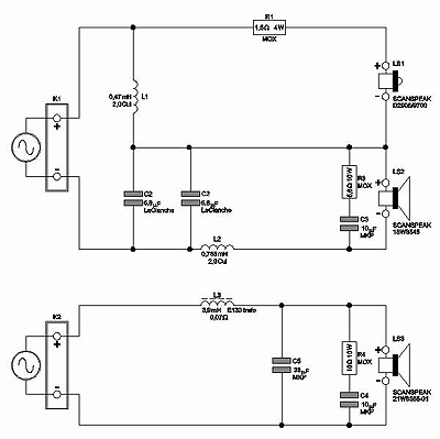

The original XO design was this:
but I never tried it this way....was told by the designer that the former schematic, in original post was more transparent...etc...
Thanks
T
*Scotty*
Sonny, I would try using the original circuit your amp may like it better and have fewer response anomalies due to the impedance variation at the crossover frequency.
Scotty
aerius
  • Posts: 383
Unless I'm reading the schematic wrong, the first x-over has the two 6.8uF capacitors for the tweeter in parallel, effectively making it a 13.6uF cap.  In the 2nd x-over, the 6.8uF caps are in series, making them a 3.4uF capacitor.  Which means the x-over frequency you have now is a lot lower than in the original, which means your tweeter's getting flopped around too much and distorting.  Try yanking out one of the 6.8uF caps in your current x-over and see if things get better.

Occam
Sonny,
The first crossover in both versions between tweeter and midrange are series crossovers -
http://www.humblehomemadehifi.com/Crossover.html
The crossover for bass driver in both is a conventional 12db/oct parallel crossover.
Both versions of the series crossovers are discussed in the above reference.
The easiest (not necessarily optimal) way to tame the tweet would be to increase R1, the 1.5 Ohm resistor.
Perhaps someone with more experience/expertise with series crossovers will chime in.....

BobM
Sonny,
That's what I was going to suggest  :duh:
But why did you move that 6.8uF cap up to the tweeter circuit? You very likely messed with the balance that the original designer had in mind. Was it too bright before? Was that your first attempt to adjust things? If "yes" then I would suggest putting it back the way it was and play with R1.

Dan_ed
  • Posts: 345
Yes, by moving that cap into the tweeter circuit you've added an additional phase change that wasn't there in the original circuit. That could easily explain the difference in what you're hearing.
I'm not at home now or I could plot the freq/phase responses for you and try to post them so you could see what changed.
BTW, it may help to simplify things by forgetting the components that are parallel to the mid and bass drivers. I don't mean physically remove them, just don't worry about them for now. They're only there for impedance correction.
Sonny

Bob et All,
Thanks for the advice...
Well, the reason I moved the 6.8 from the tweeter down to the mid was because that was what was recommended by the designer himself...to him, this yield a better sense of detail and high freq. extension...Perhpas this weekend I should try an put things back to the original...if I do that, should I reinstall the 22ohm resistor across the Tweeter?

Dan_ed
  • Posts: 345
Sonny,
did the designer recommend removing that 22 ohm resistor, R2?  Seems to me that R1 and R2 are functioning as an L-pad. Without the Z value of the tweeter it is not possible to know what the attenuation is. Removing that resistor, R2, could make the tweeter sound pretty hot.
Sonny
Sonny,
Well, the designer did condone the new XO design...that I know...He, Tony of Humble Homemade Hifi, suggested that I 1) increase the value of the 1.5 ohm (R1) to something like a 1.8 or 2.2 ohm and/or 2) add a LCR network across the tweeter with a L of 2.2mH, a C of 47uF and a R of 4.7 ohm...
The funny thing is that on my 4 ohm tap, the tweeter isn't so hot, it's actually great there...  :scratch: :scratch:

Sonny
Thanks...I will try a quick bypass of one of the 6.8 caps this weekend and see...

Sonny
I think the issue here is "impedance" of the tweeter...which based on the switching from the 4 ohm to 8 ohm taps on the Tube Amps, makes a huge difference...Perhaps a LCR network across the tweeter will help flaten out the Impedance of the tweeter....
Thoughts??? :scratch:
*Scotty*
Sonny,I think it is a question of your amp not liking the impedance it sees at the crossover frequency between the woofer and the tweeter.
Adding an impedance flattening network may do a lot of good good in this case. You can also fudge the impedance of the tweeter up to 8ohms with the L pad. If you do this the crossover parts values will have to reflect this change. I was wondering what the designed crossover frequency of your speaker is?  If I was playing with these drivers I would follow the tweeters recommended crossover of 2.8Khz. at 12dB/oct. to avoid distortion problems and maybe cross the woofer over at 1.3kHz at 12dB/oct. to try to suppress the approximately 7dB spike in it's output at 3.2kHz. The idea with the 1.3kHz. woofer xover point is to hopefully wind up with an acoustical roll off of 12 dB/oct at 2.8kHz. thus matching up with the tweeter. The tweeter looks like it will need about 2dB of attenuation to equal the efficiency of the woofer. The original XO design may
accomplish these goals with a better behaved impedance curve at the xover frequency.
    Bear in mind that most of my post regarding the drivers and how I would design the crossover is based on the mfg published data does not reflect the drivers real world measured behavior and their interaction with each other and the crossover parts within the context of a series network.

Sonny
Scotty and All...
Thanks for your responses...
Tonight, I got home and put back the 22 ohm in an L-Pad with the 1.5 ohm....
So far, this seems to do the trick and right now, I am listening to Chet Atkins's "Stay Tuned" and it sounds great!!!  I am happy at the moment...
Earlier, I listened to the Patricia Barbers's "Companion" and on cut 2, 5, and "Light My Fire", what was annoying in the highs is now listenable and enjoyable...I don't know why that first time I put in the 22 ohm, I didn't feel the difference...but with it in now, it seems to take the tweeter down about 2 db and that, so far, is doing the trick for me...
FYI, the XO design was done by Tony Gees and some others....
DIY is fun, but can also be a heartache...definitely not your "buy good speakers, hook up, placement and toe-in" and listen procedures...but DIY is absolutely rewarding!!!
Perhaps this weekend, I will move one of the 6.8uF Cap in up to the tweeter like the Original XO design (XO #2 in this thread)...
Thanks All...and stay tuned!!! :thumb:

Last Chatper, I left off with doing nothing but adding the 22 ohm back on the tweeter in the L-Pad to attenuate the tweeter, and I said I was happy, and I was!  But then, I got to thinking, what if I reverted back to the the Original XO with the 6.8uF cap back in the tweeter Series and the 1.5 ohm and 22 ohm???
WHAT IF???  So, I de-wired and re-wired the XOs, and was all excited to plug it in...and what happened????  :scratch: :scratch:
What did the Original XO reveal???  Well,  :banghead: :bawl:  no really anything good...the bass was not muddled (I guess pulling that 6.8 uf from the Midrange really messed with the balance of the whole speaker... :scratch:  Then, well, the tweeter was still hot and just sounded compressed, no air, nuttin' :duh: :duh:
No wonder why they made the change.... So, back to the de-wiring and re-wiring, back to the current with the added 22ohm...now, things are better, clearer, more transparent, balanced, bass / mid is nice, not muddled, tweeter is revealing...and well, everything is back to normal, less a tweeter at approximately 2 db attenuated down...
