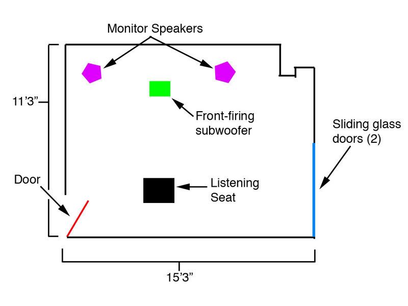

I don't know what is wrong with my setup but I imagine at this point it must be some inherent quality of my room dimensions that makes the image always skew to the right; singers are always off to the right a good bit, a little more than halfway to the right of the midpoint between the centerpoint between the speakers and the right monitor.
I've tried moving the speakers around within their respective locations (I can't change the entire layout of the room), swapping speakers and speaker cables and interconnects and none of these have done anything to help.  I'm pretty sure its the room causing this, but I don't know how to fix it with the room treatments I have, or if it would even be possible to in the first place.  My room is slightly odd shaped but not THAT oddly shaped, so maybe this is solvable?  Perhaps some diffusion is needed somewhere?
As far as acoustic treatments go, I have two GIK tri-traps and three GIK 242 panels, as well as a single Eighth Nerve Adapt that I have yet to mount, mainly because I'm not sure where it would be most effective.  I put the two GIK tri-traps in the front corners behind the speakers, with one 242 directly behind the listening chair, and the other two covering the first reflection points on the sidewalls.  I thought I had all of the bases covered in at least a basic way, but these room treatments haven't fixed this problem of imaging askew...
Please, anybody, anybody at all that has had this problem and been able to fix it help me out!  I feel like my system is finally dialed in for the most part but the way it images is really driving me crazy because I can't seem to fix it or even make it better.  :evil:  I attached a diagram of my room below for anybody that can help another ACer out...the position of the subwoofer has been relocated and I am still experimenting with that, but the imaging is always to the right, even with the subwoofer off obviously.
EDIT:  The left and right channels (which by the way are Zu Tones) are now equal distances from the right and left walls; I moved some furniture that prevented this before, which is why in the diagram below the right channel has more space from the sidewall than the left channel.  This is no longer the case.

Have you tried covering those glass doors on your right?
IronLion
  • Posts: 832
Yeah, I tried covering them with all three of my 242 panels; little to no change unfortunately...

Well, you'll have more than 1 reflection point on each side wall and most likely 1 panel on each side won't cover both of them in your setup - especially with the non-symmetry.
Bryan
IronLion
  • Posts: 832
Bryan
Hey Bryan, can you elaborate some more upon this and perhaps indicate where you think the other reflection points would be?  I just went by the basic "where you would see the speakers on the sidewalls with a mirror" rule.

I have I've always had the same exact problem.  The image skews to the right no matter what I do.  The funny part is that you seem to have a little extra room on the right while i have extra room on the left. :scratch: I've added an extra Realtraps minitrap and Realtraps FRZ to the right wall and it's helped a little. The glass in your sliding doors might be reflecting back more sound than wall on the left with the door. If you cover the two glass sliding doors with thick foam or just replace them with drywall and replace the door with a bass trap it might help :lol:

As for the reflection points, what you did was correct.  However, remember that you have a point for each speaker on each wall.  Many people make the error of only finding the point for the speaker closest to the wall.  On the right wall, there will be a reflection from both the left and right speaker for each listening position.  2 speakers, 2 seats, 4 points.  2 speakers, 3 seats, 6 points - etc.
