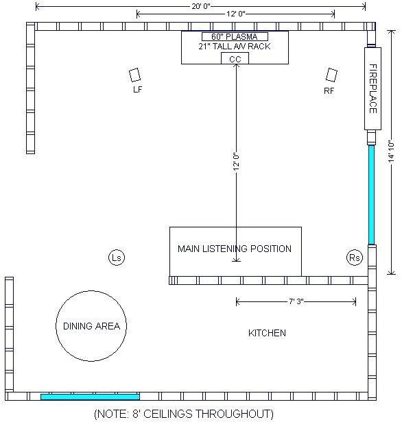

I'm searching for the best 3 front channels I can buy for $2-3k.  Thanks to the wife I'm confined to Maple veneer only.  I'm limiting myself to floorstanding speakers for the mains to satisfy my appreciation for a full sound.  The three front channels will ultimately be used in a 5.1 system for 70% HT (5.1), 30% music (2.1).  I listen to mostly rock and hip-hop, with a newfound appreciation for jazz (all at high volume).  My sub will most likely be an SVS SB-12 Plus.  It houses a 12" woofer in a 14"x14"x15" sealed cabinet and a 425 Watt amp.
My room is 20' W x 15' D x 8' H with openings to a small dining room and adjoining kitchen.
I've demoed Dynaudio 72's and thought they had excellent bass response for the dollar.  Some new alternatives have surfaced and would appreciate some opinions on them and whether any one is a better match for my Rotel solid-state Amp (specs below)...

I've auditioned the Dynaudio and although I believe it's up to par in sound quality I'm sure it's finish pales in comparision to the SongTowers.  I plan to audition the Vienna's soon.  I've heard so many good things about the Salks and Tyler Acoustics that I'm tempted buy one or the other blind.  I've included a layout of my living room.  I'm wondering if it makes sense to go with a front ported design since the left and right speakers are different distances from the side walls.
Thanks in advance for your replies!
