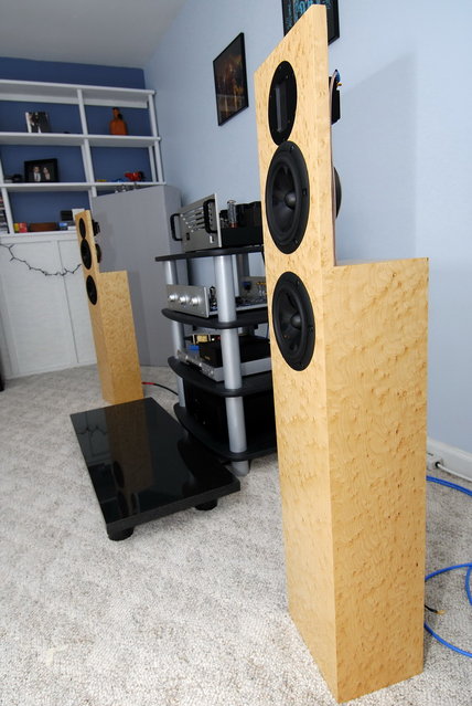

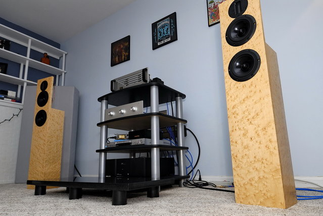

My suggestions after building a pair, make the cabinet at least 3 inches deeper - both because it looks funny so shallow, and because it's pretty hard getting your hand around in the shallow cab once it's assembled.  To offset that extra volume, make a false floor that's removable and mount the crossovers there.  They need some high mass bases too, since the cabinet is tall and light, it wobbles easy and I'd assume driver motions have more impact on those cabs than is typical.
Here are a couple pics of mine btw, birds eye maple wiped with about 10 coats of gloss tung oil

Wow!  Those look very nice!  I've done some Birds Eye Maple veneer before.  A gloss finish really looks nice on it.  BTW, did you veneer the back side of the open baffle, paint it black, or just leave it raw MDF?
From an aesthetic point of view, I would probably prefer them deeper as well.

Thanks for the compliment Al, they did turn out pretty nice looking ... although I know where every minute flaw is on them :)
I veneered every visible area of them, including the back of the open section ... it looks really nice that way, almost like it's cut from one big chunk of wood.
