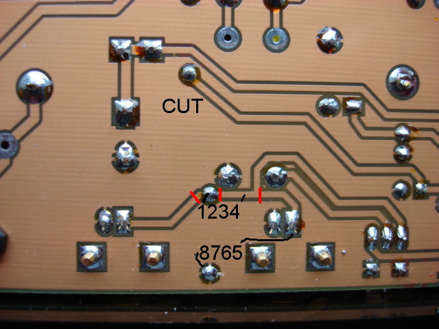

Builder Brad
Re: Paradisea DAC Mod
« Reply #23 on: 8 May 2007, 07:29 pm »
SC947-02 signal tranformers arrived in the post less that 1 week to the UK! we sometimes wait longer for local mail!
Cheers Josh
hopefully I have managed to get the correct image to display above, otherwise I am in trouble aa
I do not normally take my time, even with the more involved mods - so this is totally out of character - I have even taken the time to take a picture and edit it!
looking at the paradisea pcb and the SC947-02 transformer there seems like an ideal position to mount this component between the output pins and the connection for the 75 ohm resistor, which keeps the traces very short and allows me to solder directly from pin 4 to the 75 ohm resistor and pin 1 signal - clearly this will only work with the traces cut as shown.
On the output side I will be able to solder directly onto, or with a very short link, the earth pad for the 75 ohm resistor and also use this earth point for the shild pins, if required (6,7). Pin 8 can then be linked to the RCA input as shown. I am not planning on using the BNC connector and this will now be redundant.
any thoughts?
is the polarity important ie pin 1 earth/signal pin 4 signal/earth?
Brad
Builder Brad
« Reply #24 on: 8 May 2007, 07:32 pm »
Builder Brad
« Reply #25 on: 8 May 2007, 07:37 pm »
here we go - hopefully this will work. I could have broken the DAC several times over in the time it has taken to work this out
Builder Brad
« Reply #26 on: 8 May 2007, 07:39 pm »
this is how I planned to position the transformer
Builder Brad
« Reply #27 on: 8 May 2007, 07:42 pm »
now I`m on a roll....
there is room to do this, obviously I will have to make sure that nothing gets shorted, and i will probably need to remodel the pcb a little.
Builder Brad
« Reply #28 on: 8 May 2007, 07:45 pm »
just looking at the pin numbers above, I can now see that they are the wrong way arounf PIN 1 is the to RSH pin with 5PIN 5 on the bottom LHS, but the general principal is the sam. My earlier question regarding the polarity is now much more relevant.
Brad
jhm731
« Reply #29 on: 8 May 2007, 11:09 pm »
Brad
Polarity is not important.
Builder Brad
« Reply #30 on: 9 May 2007, 05:36 pm »
just 2 be sure I can connect the primary (pins 1&4)either way round from signal to ground effectively across the 75 ohm resistor.

Builder Brad
« Reply #32 on: 9 May 2007, 07:02 pm »
cheers Tan
one last Q. does the pin numbering on this transformer follow the normal IC convention ie. clockwise from the marked no 1 pin with 1+5 on opposite corners?
Brad

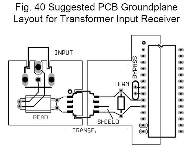

GBB
« Reply #39 on: 10 May 2007, 04:46 am »
Mr.Paul told me the shields should face the driving or driven IC.
Just to clarify this comment, in their FAQ http://www.scientificonversion.com/faq.html, Scientific Conversions
highlights Fig 40 of their AES 2003 paper as a good reference for reducing EMI emission and susceptibility.  It shows the shield side of the transformer going towards the DAC receiver chip.
So I believe you are suggesting that on the SB3 side of the system, the secondary of the transformer should be driven and the primary should go to the SPDIF output jack.  And on the DAC receiver side, the primary should go to the SPDIF jack and the secondary should go to the DAC receiver as shown in the Figure.
Is that right?
---Gary
