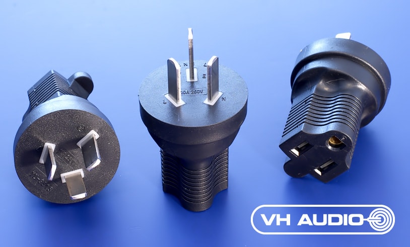

Darren,
It sounds like you need some of these from VH Audio:
http://www.vhaudio.com/images/vhaussie.jpg
They are 19.95 each, and do the job well.
Steve

Hi Steve, thanks but the US to Aus adaptors I've been using for the last few years are sonically transparent, are available locally and are cheaper than the VH ones. The adaptor that I mentioned that collapsed the soundstage was an Aus to US one (the reverse of the VH plug you linked to and the adaptors I already use) as it was for use on an AC cord with Aus plug going into an AC conditioner with US sockets. It was only for use in a temporary test as I traced some hum and was so bad that it was ripped out and cast across the room to come to rest in a dark corner, never to be used again.
