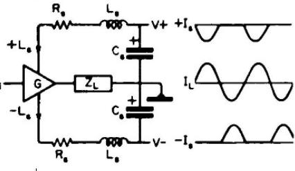

OK here goes.
Class B and Class AB amplifiers are notorious for the generation of switching or crossover distortion especially at higher frequencies related to the on/off switching speed of the push-pull output stages.
When amplifying a pure sinewave (of which all music is composed) one half of the output stage switches on for half the time, and then the other, so they produce half of the output signal each. In Fig 1 above Zl is the speaker. The full sinewave cycle is shown to the right. This is shown as a current across the speaker load.
more to follow...
« Last Edit: 24 Jan 2007, 12:34 am by amplifierguru »
amplifierguru
Re: SKA Killer Amps
« Reply #12 on: 24 Jan 2007, 12:52 am »
So we have a Class B amplifier gain block of gain G outputting a sinewave to a load Zl, and, for simplicity, we'll consider the case of a resistive load so Zl = Rl and the current and voltage at the output are thus in phase.
So the half waveform above the line (+ve going signal) will be supplied by the upper half of the push pull output stage and the half below the line from the lower output stage half.
So we have two half wave waveforms from the two halves of the output stage combining in the load to give the final output sinewave. These will alternately draw current from the power supplies as the current is demanded to maintain the waveform across the load. Shown in Fig 1 are the current waveforms drawn from the supplies, above and below the output waveform.
These currents can be shown to have the fourier series as in Fig 2
So our Class B amplifier generates a spray of harmonics of the pure sinewave signal frequency in both supply currents according to the coefficients in front of the terms cos2wt (second harmonic) , cos4wt (4th harmonic), etc... relative to the fundamental frequency term sinwt.
more to follow...
