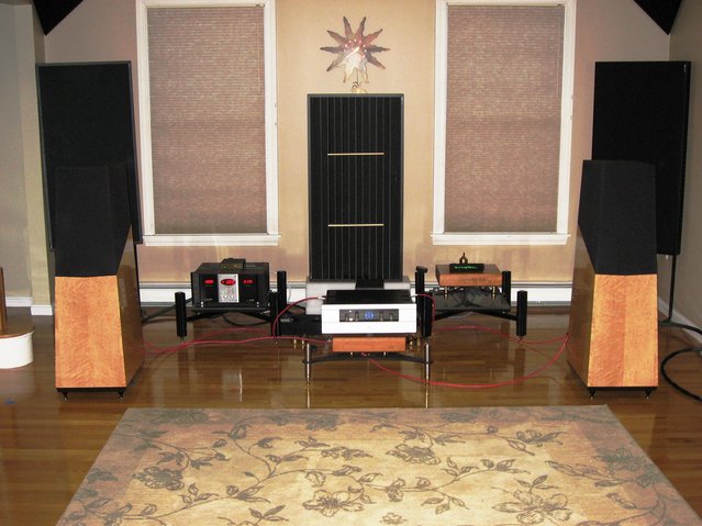

James,
My room looks like this.
Are you willing to put stuff on the walls and ceilings like this?  My wife let's me get a way with just about anything in my man cave but where do you stand?  I mean how much "artistic" freedom do you have?  Also, is budget and issue?

Re: Room Set Up
« Reply #8 on: 20 Jan 2007, 03:54 pm »
LOL so hard if I were drinking milk it would be coming out my nose.
Nice photos BTW. :thumb:
