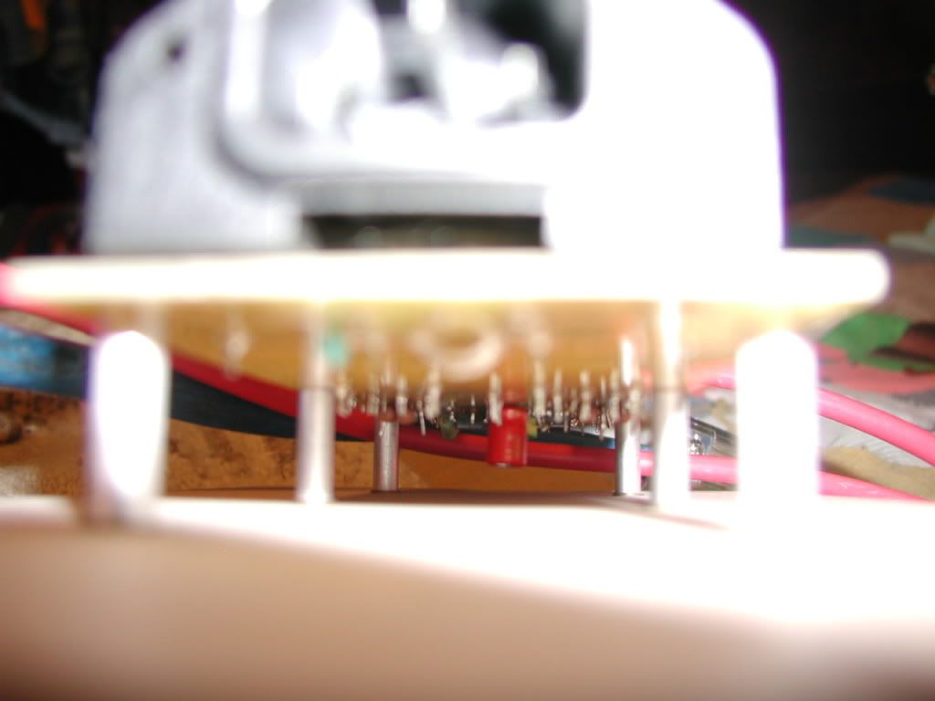

I built the DAC and got the USB to SPDIF as well. I am using an SLA battery to power it (8ah, with a charger) that run accross parrellel Panasonic 1500uf 50v capacitors (had laying about).
I think the inline mount for the capacitors is pretty nifty myself  8) .
The mounted board is a bit cheasy. I found it (a foot rest, it had things on the bottom you could fold out) in a car while I was working at a rental car place. I had nothing else to use haha...
This is actually a Christmas present for someone else.
I find it to be slightly bright despite my use of CAT5 for the leads to some Nutrik RCA plugs. I suppose it has some burn in time to go. In the first two hours it went from a tight soundstage to a normal one. The detail came out, and the smoothness. Now I admit I need to put in new resistors for my tweeters (everything is over bright for me right now) but I know that stuff is brighter through this DAC. I hope that dies. I hope it continues to get smoother and increased midrange. I will say that it does NOT have a dark background. It sounds more like Vinyl background (my amp contributes a tiny bit to this as I still need an X2 capacitor across the IEC) but quiet with no pops or crackles; it is actually kind of pleasing. The detail is nice, I would not rate the transparency to be exciting (if there). I will say that it is no Bel Canto DAC3 for detail though. Strange enough the smoothness is not far off from expensive DACs. If this thing gets a little less bright, well I would consider it good enough for anyone entry level, or as an upgrade for a lot of CD players.
I imagine the USB might be adding some to the background. It is as simple as possible. I hope to use a Hagtech USB myself as it uses a transformer to eliminate problems with the USB. However I think the people getting this with some speakers and hopefully (if I can save it) an amplifier for Christmas, will like it.
You are welcome to make fun of my mounting of the capacitors, I know some of you bastards are good for it :lol: .
Oh and HUGE thanks to Lei Song from HifiDIY for going out of his way to get me this stuff in time for Christmas. I would of felt weird giving them half of a present :duh: .

   Anyway, congratulation on completing the kit. BTW... just wonder you mentioned that this is an Xmas gift for someone right? Did you give it to that person as showed in your picture? With the rubber board and all?

You better believe they are getting a "rubber" board :thumb: .
