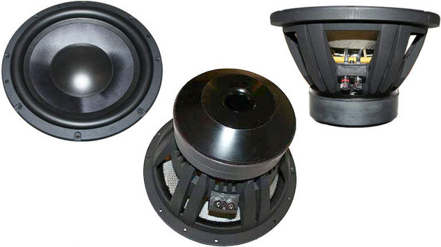

The first subwoofer driver in a series of products. From the Latin - "to lead from below" - Get the bass right and you establish a firm foundation for the rest of your music and sound reproduction.
Preliminary parmeters:
Re: 3.6
Le:1.45
Fs: 23.3
Qms: 2.87
Qes: 0.447
Qts: 0.387
Vas: 83.3
Cms: 0.25
SD: 490
Xmax 19.5
Xmech: 32
BL: 14.6
Mms: 186.4
SPL: 85.6
- Fiberglass/Nomex honeycomb cone with NBR surround
- High power and low inductance design.  2 layer 3” copper voice coil and large aluminum shorting ring inside the magnet
- Forged and machined t-yoke and top plate with larger radiused pole vent for low aerodynamic noise
- High excursion spider with integrated lead wire
- Attractive cast aluminum basket design with cast aluminum trim ring.
- Long Xmax and a “bottomless” basket design
SD12 preorder is  US$155, C$179 plus shipping at $28.
shipping date mid January
We will have this driver in a finished sub with a very good amp whichwe are getting in place now.Price for the small finished sub 18" cube(1.25" MDF) $999.00

Is that using the XBL 2^ motor?  Is that your driver?

That woofer looks like it means business. Will the 18" cube be sealed, PR, or vented? What kind of power does the amp put out?

The driver is not XBL^2 motor but there is one in the works.
Still a very good driver for the money.
The driver is a CSS driver which we work with Bob at CSS and we are selling the drivers,amps as well as finished subs.
Jack
Sealed is best with 6db of boost around 25hz.
