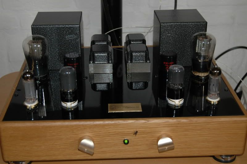

I'll try to add a picture of my system so that you can see where the Promi is going to end up.

One more picture of my amps.
Jos
Jos
Re: Promitheus TVC passive preamp anyone?
« Reply #2005 on: 19 Jul 2007, 11:31 pm »
I'm so happy the pictures work that I'll add one more of my pre.
GHM
« Reply #2006 on: 19 Jul 2007, 11:54 pm »
Jos you have some beautiful equipment there! Very nice indeed! aa What are those speakers?
You're quick with that camera..you caught a fly relaxing on the preamp.

I am assuming the 1st is your speakers, the 2nd your amp and the 3rd your preamp??  If that is pushpull transmitter with 100+db speakers, no wonder you have too much gain!  The only reason why the TVC wouldn't work in this case is too long of cables or a pathetic output impedance (~drive capability) of your source.
If you really wanted to keep your current equiptment and the TVC doesn't work for you, you can use a step down output transformer on your preamp.  This will lower the gain of your preamp and lower the output impedance (Zout, which makes its drive capability go up) as well.
Jos
Very nice Jos. Should you have an interest in NOS RCA or United Electronics 211's let me know   Gerry

The speakers consist of the following components:
B&C DE 25-16 tweeters.
Iwata Horns with Philips EL 5502 Drivers
Altec Lansing 515C bas units in Onken Grand enclosures.
Sensitivity: 98dB.
Tachiro, I bought them from a German Herr Doctor who had them handmade in Italy. Cost him a fortune but he simply wanted a change after living with them for a few years. I'll post a picture of the crossovers
They gave me a shock when I first saw them; the size of beercrates and I'm not talking sixpacks.
The power amps are 90 Watt set using parallel 845's.
I kind of like the fly myself, gives it all a 'human'touch.
Rollo, wouldn't it be possible to use the TVC with my pre amp, or is that putting the horse behind the cart?
