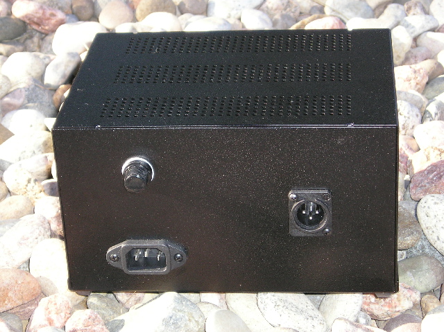

We have nailed down the system we are going to use at RMAF.
It will feature the highly modified SB2 that Barry recently auditioned here
It will be powered by an Ultimate Power Supply MKII
I should also have a stock power supply and a modded ELPAC on hand for comparisons.

The interconnect cable from the SB2 to the tube amps will be Harmonic Technology CyberLight. They will be supplied by TweekGeek. They will be powered by a custom power supply based on the Ultimate PS. The DC cable will be a NITRO design. Speaker cables will be NITRO.

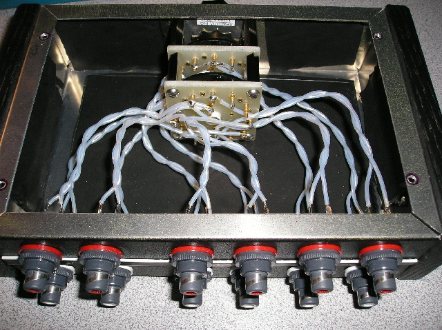

We are also going to have a VERY high end switch box so different mods can be compared.
It will have 4 in and 2 out. All SILVER WBT NextGen connectors  :o
Shallco switch and Summit Silver internal wiring. The case was made by Dr. Lloyd of Mapletree Audio Design

Berndt,
Dr Lloyd Peppard used the case from his LR-1 switcher. It was something that was one of his stock case designs. I had the actual switch shipped to him so he could mount it. The switch I selected is a bit different than the one normally used in the stock LR-1. I also shipped him a couple of WBT NextGen connectors so he could make certain they would fit.
This was the first time I worked with Dr. Peppard. Everything went very smoothly.
Here are some photos of "The Ultimate LR-1 switcher"
Front of the switcher. Not too different from the normal one from Mapletree. Only one knob instead of the stock two.
Here is where things start to get interesting  :D One dozen WBT NextGen Silver Reference female RCA jacks  :o
Here are the guts. I installed all the WBTs and wired them up to the switch with solid core, cryo-treated, 99.9995% pure silver wire with Teflon insulation. Interior of the case is lined with VMAXX dampening material. The case itself is steel to keep out any RFI.
The left and right channels are switched on separate decks. Signal and ground inputs are also separate and switched. No ground loops possible. There is a fair amount of distance between the positions to prevent crosstalk. This is possibly the most transparent switch box around. Certainly one of the most expensive.
