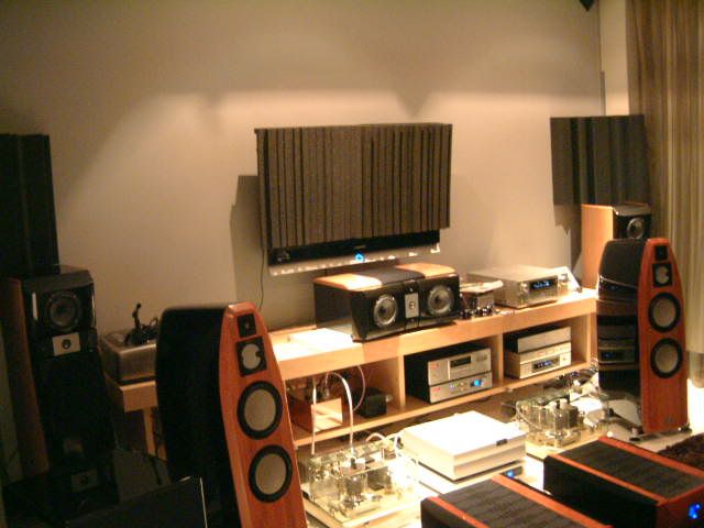

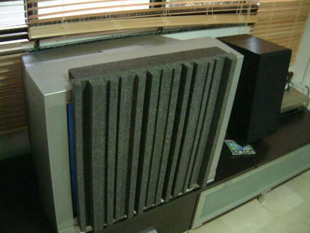

Hi,sorry for the mislead,the last picture I post was my living room and the Close cell foam Diffuser infront of the TV set is somthing I make for sale in my country...these photo is only to show my customer how these diffuser can be use for...

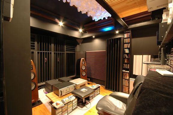

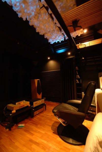

These is my room old photo.
I have recently do some rearrangement of the loudspeaker back wall diffuser and some other major re-arrangment, but still no time to take a photo....will post the latest photo later on if you interested.
Now(not the same as the photo) the 2/3 wall area behind my speaker is cover will absortion , the centre area diffuser remain...while my listener back wall are all difffuser and side wall 60-70% cover with 4" foam .....8 foam LENRD bass trap and a pair of MegaLENRD Bass Trap all place at the ceiling corner...and not to foget a pair of Real trap is place behind my speaker 2 back corner.  :lol:
I found these configeration of Absorbtion/Diffuser/Bass trap make the best small sound room(3m X 4.2m) I hear so far from my humble 20 years of Audiophile experience...but of couse,if I have a bigger room I should able to make it even better... :lol:
back to the topic.
Why I believe loudspeaker back wall affected sound is because I hear it from my system, that it able to transform my system from good, into unlistenable if I place incorrect treatment behind the loudspeaker...
I like the effect of a diffuser at the centre of loudspeaker, because it sound like I have added in a centre loudspeaker in my system.....even I seat slight off centre, I can still feel the vocal or violin etc sound like its from the phatom centre (as like in real life) even when only using 2 LR speaker.
But for the wall direct behind the speaker, I notice if I use diffuser at these area,the imaging will be affected,and the sound become too "live" in some fast music...
I hope you can try that too,with your expertise you should be able to find out more than me...
Espeacially the diffuser infront of  TV glass ,it is very effective, one of my customer told me:
"once place this diffuser infront of my TV set, now I unable to listen music without it...the soundstage become very flat , and vocal sound like shouting, instead of singing to me......." :lol:
