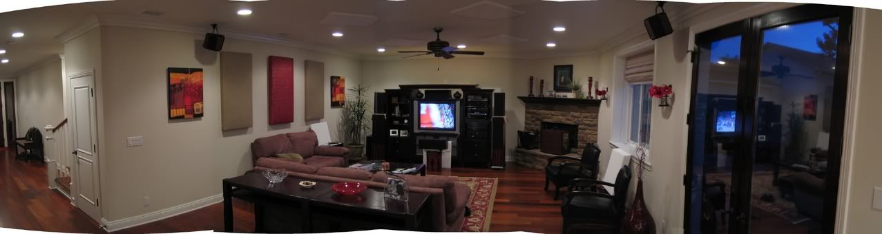

I have a dual purpose 'great room' that is somewhat open to the rest of the house.  The entire back of my downstars is 44' wide, half is the kitchen and half is the family room.  The width is 18' and the ceiling 9'.  The floor is hardwood with a concrete slab underneath.
I currently have some DIY panels on the wall and behind the entertainment center.  I'm thinking of covering the three walls of the family room floor to ceiling with 2'x2'x1" (JM is300 which is OC703 equal).
The other thing I'm thinking of is to have a heavy curtain that will separate the family room when I want to watch movies.  My questions are:
1)  Should I go floor to ceiling with the fabric wrapped panels I want to build
2) Will a curtain make enough of a difference or is it not worth it (Building a wall or adding doors is not an option)
3) Does anyone have any other suggestions.

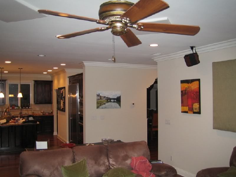

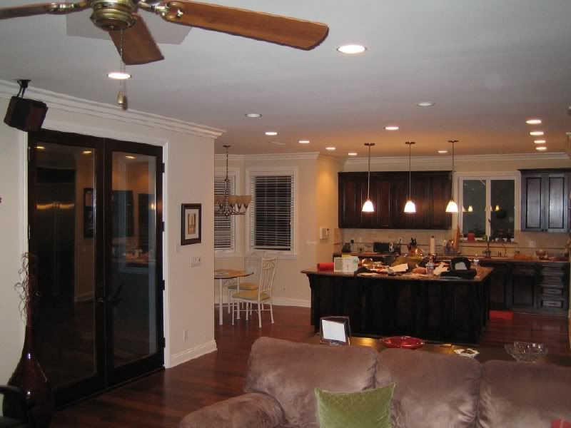

First suggestion: Remove the ceiling fan and listen again.  You can't imagine how much damage those big hanging resonating reflectors do to the sound (off or on) until you hear the system with them gone.

Something probably need to be done to treat the glass window on your right since it's your first reflection point.  I wouldn't worry too much on the acoustics in a room like that.  Just have fun.  What you got in that wine cellar?  I will come over and lend you a hand over a bottle of say a 1998 Cheval Blanc.  2000 would be okay too. :lol:  :lol:

I guess by the bottom two pictures the ceiling fan looks like it dominates the room but if you see the panoramic one it really doesn't.  Considering how much flat surface area there is in the rest of the room I would think the ceiling fan might help a little with diffusion (A very little I know).

I also forgot to say that the windown on the right has a fabric blind (it's pulled up in the picture).  It's not the best but better than nothing.  I think by looking at the picture there has to a serious balance between looks and function.  I have to be creative with my treatments.

Pull the fan listen again.  Or, don't.  I've only been doing this for 55 years.

I'd think after 55 years you would have come up with a solution that doesn't include removal.  If the housing resonates, add damping.  If the blades are too uniformly reflective, add some creative dispersion to the ceiling above the fan, or move the ceiling fan closer to the seating position (where it would do a better job anyway).  I think that wall of TV and other stuff flush with your speaker placement is likely to be far more detrimental to the sound than the ceiling fan.  I'd experiment with speaker placement before doing anything else.

I am just staying pull it down for a trial listen.  I bet it won't go back up again.  Ceiling fans are a huge acoustical problem.  Been there, heard that myself in my own sound room.  Nothing else helped much at all until I finally looked up and said "duhhhha" and dropped the fan.  I would never had guessed.
