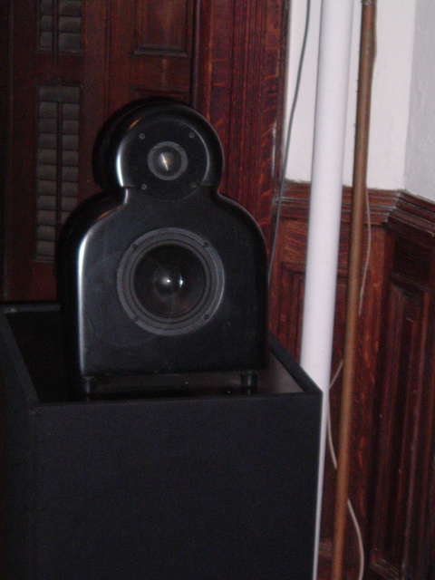

mcgsxr
What dimensions were your B200 open baffle designs?
« Reply #2 on: 20 Apr 2006, 01:56 pm »
And then...

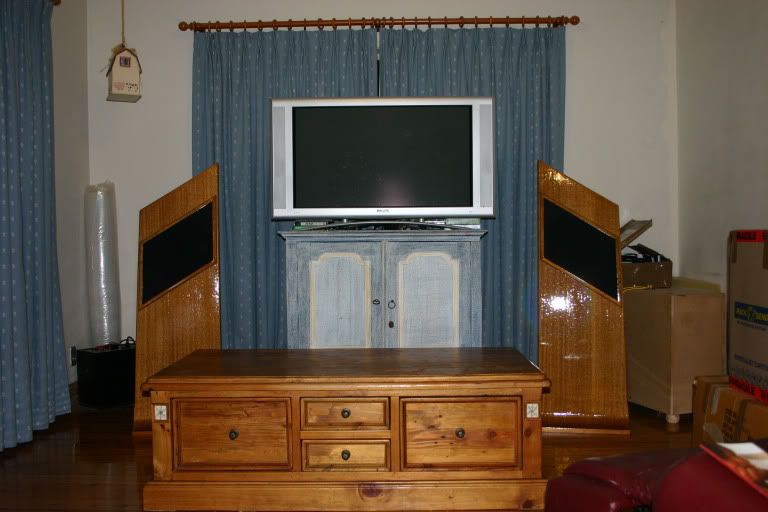

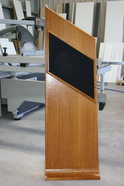

This my take on the B200. The design satifys my passion for detail, and my need to make an unusual looking speaker. The driver is magnet mounted. They sound amazing. 8)

barfind....Nice work !! Can you tell me....from the center of your speaker, down to the floor (base)....how many inches is that ? Thanks...enjoy !!
    Chris[/list:u]
barfind
« Reply #10 on: 29 Apr 2006, 10:34 am »
Hi Chris  The driver is 36" to the centre. Heres the baffle dimensions. I made them from 25mm HDF, and venered then with teak veneer.
