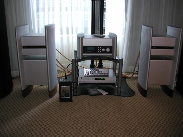

I use Richard Gray Power Company products.   Almost all CES and HE shows used them in their demo rooms.

Quote from: Levi
I would say this is mostly true for HT demos.  But at HE and particularly the most recent CES, Shunyata Hydra-8 and Audience adeptResponse were the most commonly used power conditioners...

Now it occured to me.  No wonder this room sounded awfull. :lol:
Quote from: PhilNYC
Quote from: Levi
