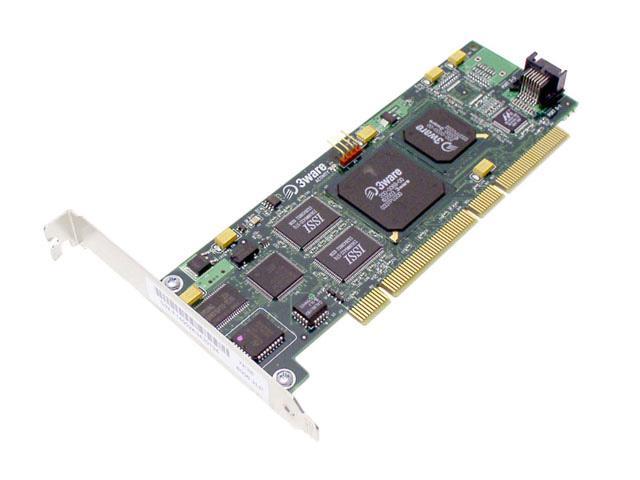

Since I've started burning my CDs into FLAC, I've quickly outstripped my ability to backup my main hard drive to my second hard drive.  I had planned on just buying two new hard drives, one for operating system/data and one for backup.  I was going to perform a disk copy using software I have (the name of which has temporarily escaped me), then replace my C: with the new drive and backup the new drive with the nameless software.  As I went to buy the drives from Newegg, though, I saw this:
http://www.newegg.com/Product/Product.asp?Item=N82E16816116030#DetailSpecs
This is a PCI SATA controller card with hardware RAID 1.  This way, I don't have to remember to backup weekly.
I would like to use RAID 1 with my two new drives.  I would also like to use these as my OS/data drives.  I would like to copy my current C: drive to a first of the new drives, have the RAID controller copy everything from the first new drive to the second new drive.  I would then remove IDE drives (c: and u:) and use the two new drives as my bootable drives.  This way, I'll have my OS, programs, and data all backed up and hot swappable.  Is this possible?  Or do I have to reinstall Windows and all other programs to the new drives then transfer the data there, then remove my C: drive?

There are many ways you can approach this.  This is what I would do:
Leave the OS where it is.
Placing your OS on RAID1 may not be a good idea fo 2 reasons.  1) If your OS get's corrupted, it will replicate to the other drive. 2) Performance will be slower.   If this is a file server, the performance penalty is neglible.  Since availability and I/O subsystem is most important.
Put data in RAID1.
Buy an additional HDD (identical to the one you just bought) and configure it as RAID1.  Move your music files to the new partition.
Sit back and relax.

Meby,
The card I bought is for hardware RAID 1 using two SATA drives.  There will be no software RAID.  My computer is already maxed out at times just running EAC and the squeezebox; there's no way I'd have it perform software RAID.  Plus, I want to set up digital room correction and use this PC for that just to test it out.  That'll be another set of complex calculations.  Thus, I went hardware RAID instead of software.

Hi Bob, Do you have an extra slot for this type of RAID card that you are looking at?  It is a 64bit slot.  It will work with 32bit slot.  You just need the space.
I am just making sure.

Honestly, I don't know.  I do believe so, but I'm not sure.  I'll check tonight (or maybe I'll wait -- NewEgg has already shipped everything and I can find out soon enough).

As for the card, it does fit.  However, there are no extra power connectors, so I had to order a splitter.  I'll take out one of my two hard drives and hope that a splitter will drive my two new drives (for RAID).  I'll then transfer all data to the RAID drives and I'll backup my main drive to the new RAID drives.

There's no way I can stress strongly enough: RAID is _not_ a backup solution.  What RAID gives you is this: If a drive fails, then you continue to run without interruption.  The alternative, that of using backups, means that if a drive fails, you have some down time while you replace the drive and restore from your backup media, or, in the case of being able to backup to a single drive, of swapping in your second drive.  RAID isn't particularly necessary for a music server if you can afford to be down for, say, an hour should a hard disk crash.
The downfalls to believing RAID is a backup solution are many.  Accidentally delete some files and they'll be deleted from both drives.  Gone.  Keeping a RAID array healthy isn't for the faint of heart.  If you lose a drive, you have to have the system set up correctly to notify you of the problem.  If you're unaware that one disk has failed, then you're much worse off than not having RAID to begin with, as you continue to think you're "protected".  If you lose the RAID controller card, you may be able to recover, maybe not, and maybe you'll hose the array in the process.
As for worrying about doing weekly backups - relax.  Once your library is completely ripped, how much ripping will you be doing weekly?  A couple discs at most?  Not really worth worrying about the time lost to restore those couple of disks.  A music library is very unlike the dynamic data of a business - you don't need fancy backup software - all you need is to sync the backup disk to make its contents identical to the original.  This should be a very quick operation, as only the changed files will need to be written to the backup disk.
I'd recommend getting a relatively small hard disk for the operating system and programs, then two identical disks for your music library and its backup.  Get an external USB enclosure for the backup disk and do your backups whenever you remember.
