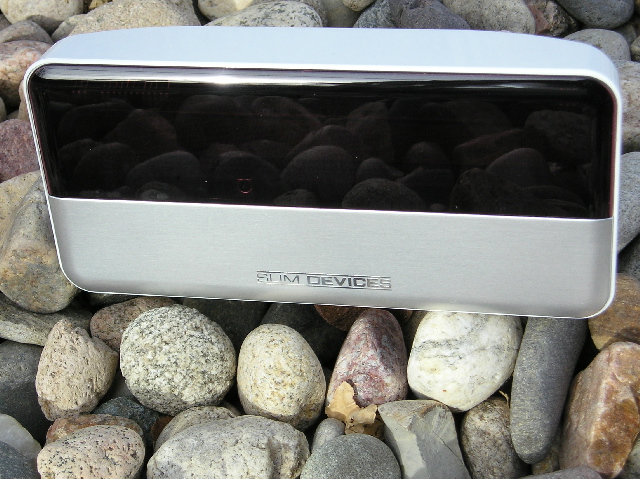

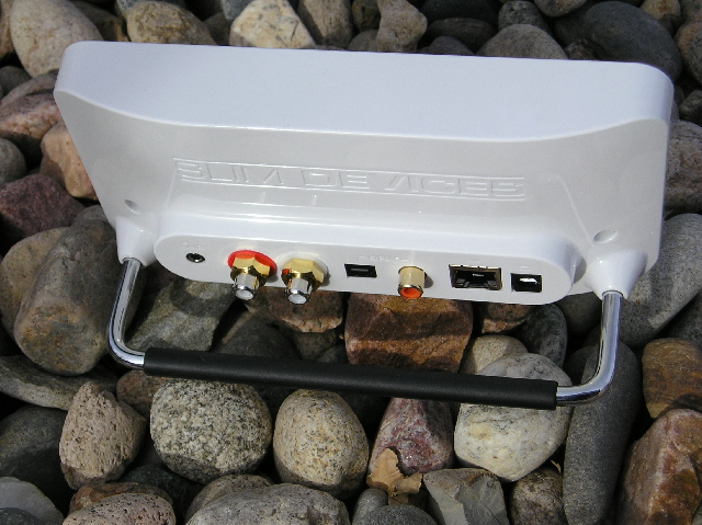

After a rather long time, I have finally decided on how I am going to offer analog mods for the SB3.
The SB3 does present quite a few challenges because of the thin case. I cannot use the same values for the main power supply caps, simply because they will not fit.
The large Sonicaps I use for coupling after the DAC won't fit either.
I thought about various means to use the big caps, such as mounting them outside and covering them up. In the end I decided that the SB3 is all about the way it looks. Hanging anything on the back will just take away from that.
I ended up using Non-polarized Black Gates by-passed with small value Sonicaps. The Sonicaps will give it the same sort of signature sound that the  modded SB2 has.
Don't ask me how it sounds, yet. The BGs plus Sonicaps will take close to a month for full break-in. This one is going out to one of the kind folks who volunteered as a beta tester. Hopefully we will hear from him how the break-in proceeds.
