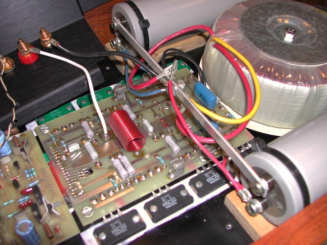

Well that wasn't so bad...  It took about an hour to ditch the dual rectifier setup and redo/finish my mods using a single bridge.  I turned it on via the same method as last time except this time no tripping power switch.  Figured that was a good sign.  Measured the rail voltage on both sides +77V and -77V just like the doctor ordered.  Put the amp back togther and checked the DC offset (it came in around 10-12mV).  Took the leap of faith and hooked up the amp to a speaker and ran some music through it.  Hey, it works!
So, in the end I did the following:
1) added a .1uF cap across the power switch (film and foil)
2) added a pair of .1uF caps across the output(s) from the tranny (same kind as above)
3) replaced the bridge rectifier w/ a fresh  400V 25A unit
3) bypassed each of the diodes in the bridge w/ a 22nF cap (4 total)
4) bypassed my two large pre-existing 26,000uF caps (one for each rail) each w/ a .47uF film and foil, a .01uF PPT Theta AudioCap and a 5K ohm 5W resistor.
Having only one amp done makes drawing any conclusions on the sound difficult (that and a bunch of virgin caps), so I'll hold my opinions until I've finished the other amp and they've been run-in a little.
Thanks again for the help.  I'll keep you posted.
Jon

Well mission accomplished!  Finished the other amp up last night and spent a couple hours listening.  I'm sure the caps will benefit from more break-in, however, right off the bat the amps did sound noticably better.  The best way I can describe it is a richer/fuller sound.  The highs are altogether more open and detailed, but w/ no harshness.  Bass seems a little "tighter" but  the bulk of the improvement is in the mids and upper octives.  Certainly worth the trouble, and the $45 in parts.
Prior to the mod I was contemplating if these would be "long-term" amps for me.  I liked them, but wasn't quite as satisfied w/ the sound as I wanted to be.  You know... just now quite there.  Now, I think we'll be enjoying their company for a while.
Thanks again,
