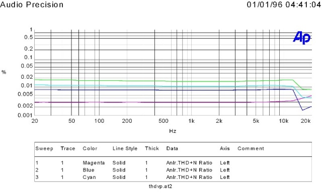

As a D-100 owner I know CIAudio/Hypex stuff best.  There are AP generated plots for the Channel Islands Class D amps right here on Audiocircle (on CIA Circle)--mainly THD vs Power and Freq. resp. info.
But there are also many Hypex plots for all sorts of parameters out on the net.
I'll link you to a THD vs Freq graph of the Hypex/CIAudio Class D amp module (....since we are already showing other makers plots, e.g., ICE):
http://www.audiocircle.com/image.php?id=5654
It looks quite good.... :D
That should allow almost exact comparison of Hypex/CIAudio and the NuForce THD vs Freq graph, which is current (7/25) on your web site (and the identical graph on the 6Moons review page):
The much discussed flat THD vs Freq., @ 8ohms, 1w, 10w, 20w, and 40w--

The specification of class-D amplifiers and their AP plots inevitably use AES17 to remove switching noise, and further, the typical fast roll-off of THD with the little kink near 20Khz is characteristic of AP filter set at 20Khz BW.
One cannot reasonably take THD measurement at 10Khz or higher with a 20Khz filter, as the 10khz THD+N number will be artificially 'improved' by the 20Khz cut-off filter.
Look at the measurement with Icepower when the AP filter is NOT set at 20Khz.   Another way to look at it is to use a pencil to extrapolate the THD+N curve all the way to 20Khz, and it'll hit 1-3% THD+N.
If you have access to an audio analyzer, like HP, or AP, set the cut-off filter to 40Khz or higher, then do the measurement.  The result will be shocking.  Set the cut-off filter to 200Khz and the "other" mentioned switching amplifier will show 15-20% THD, while the NuForce Ref9 is still <0.2%
rustydoglim
Hi Casey,
Regarding the UcD400 plot I linked:
I know the NuForce objection to setting the AES at 22Khz--and that they used 30khz--the UcD400 plot was done at 40khz.
http://www.audiocir ...
If you refer to this specific link, it has the 20Khz filter, see the 20Khz extreme roll down and the classic 'kink'.

However....as you have disputed my post above I kinda gotta, reluctantly, re-state the facts to preserve accuracy:
It was done on an AP2 (SYS2322) with the AES17 set at 40kHz bandwidth--not 20kHz.
The downturn after 16kHz is when the 3rd harmonic shifts outside the 40kHz measurement bandwidth.
