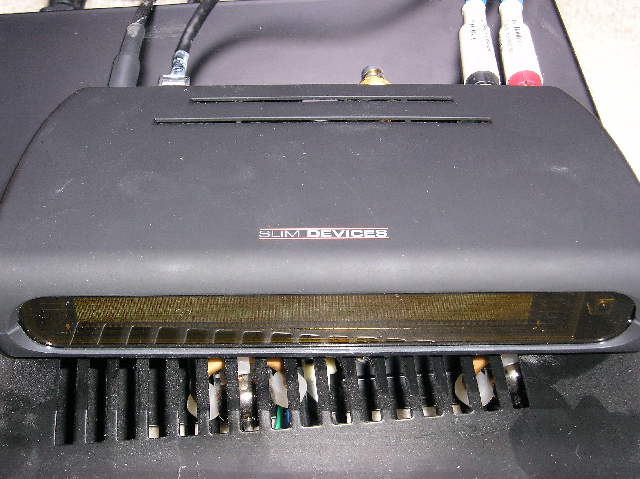

Here are a couple of photos of the power supply for the Squeezebox 2 and the modded unit. You can just barely see the WBT digital output in the back of the unit.
It is sounding very good so far, but it does need some time, and a little less dust ;-)
I talked with mgalusha earlier and it turns out he has just gotten a Squeezebox 2 for himself. We are going to try to get together on Sunday to do a little comparison of the two units.
