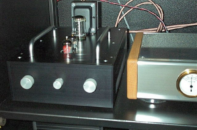

Here's the start of my Clarinet.  No wild deviations from the plan (I want to make sure it works from the beginning), just a few different parts such as Auricaps, all Panasonic PS caps, Kiwame resistors (thanks to bluesky)  and good RCA jacks for panel mounting.  I'm awating the arrival of a pair of Auricaps for the last two slots (supplier sent the wrong values  :( ).
BTW, some may notice that the two larger Auricaps have wires emerging from the edge of the cylinder instead of from the middle.  These are from a cap line designed for circuit board mounting and the leads come bare.  The "red" lead is longer which determines it's orientation, thanks to Roger Sheker for the help on those.  And... I used the larger 2.2uF's there because they fit and I had them. :wink:
I was impressed by the quality of the Bugle kit and this one further demonstrates that Jim offers boards/kits of the highest quality and value.  Now, time to think about pokng holes in that aluminum chassis...
ohenry
It's done
« Reply #10 on: 16 Oct 2005, 10:14 pm »
I had fun with this one, it sounded great from the start.  Bests my AES 3 6SN7 with the expensive audio note PIO's, hex fred diodes, costly NOS tubes and all the point-to point magic.  It sacifices nothing in tone to the AES 3, but adds wonderful dynamics, texture and quickness.  I'd describe it to be honest and balanced.
Great bass and smooth highs using kiwame resistors, auricaps, an NOS Sylvania rectifier tube and some new JJ 12AU7's (everything else is stock except the RCA's).  Also, it's very, very quiet.
If you like Jim's phono products, this one is another winner IMO.  Sorry about the fuzzy photo...:)

« Reply #11 on: 16 Oct 2005, 11:01 pm »
Great for you, Henry!
Love the handles!! :mrgreen:

« Reply #12 on: 17 Oct 2005, 05:13 am »
Yes, those look great!  I like the handles - where did you source them from?
Also - any issues with microphonics on your clarinet?  I realize this is usually a tube-related issue but mine is very sensitive to the tube I use in the middle spot especially...

« Reply #14 on: 17 Oct 2005, 11:56 am »
Quote from: Eric H
The handles came from Design, Build, Listen:
http://www.designbuildlisten.com/?x=42&y=10
Those guys are nice and it didn't take very long to get them all the way from NZ.
I haven't noticed any microphonic issues with the JJ's or EI's I've tried so far.  In my experiecne, it seems that the best sounding NOS tubes tend to be microphonic.  :|
