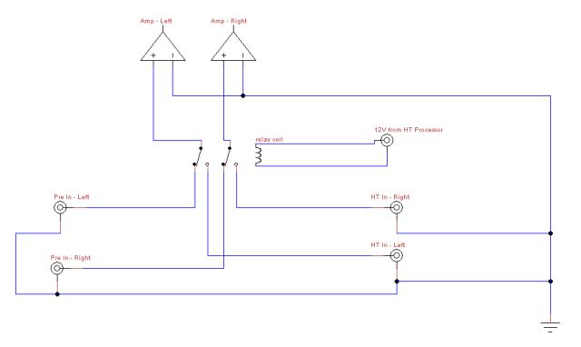

You will also need some type of connector to connect the relay to the 12V lead from your HT pre. The connector will connect to the relay coil. I strongly suggest NOT using an RCA connector for this purpose, as this will prevent you from accidentally plugging the trigger lead into an input jack. :bawl:
Below is a quick & dirty schematic of how this could be wired up. Note the "amp" blocks are just a generic IC module symbol.

That's perfect, I appreciate the effort. My HT pre uses a 1/8 mini jack for the turn on signal, I'm sure  the shack has input jacks for that.
