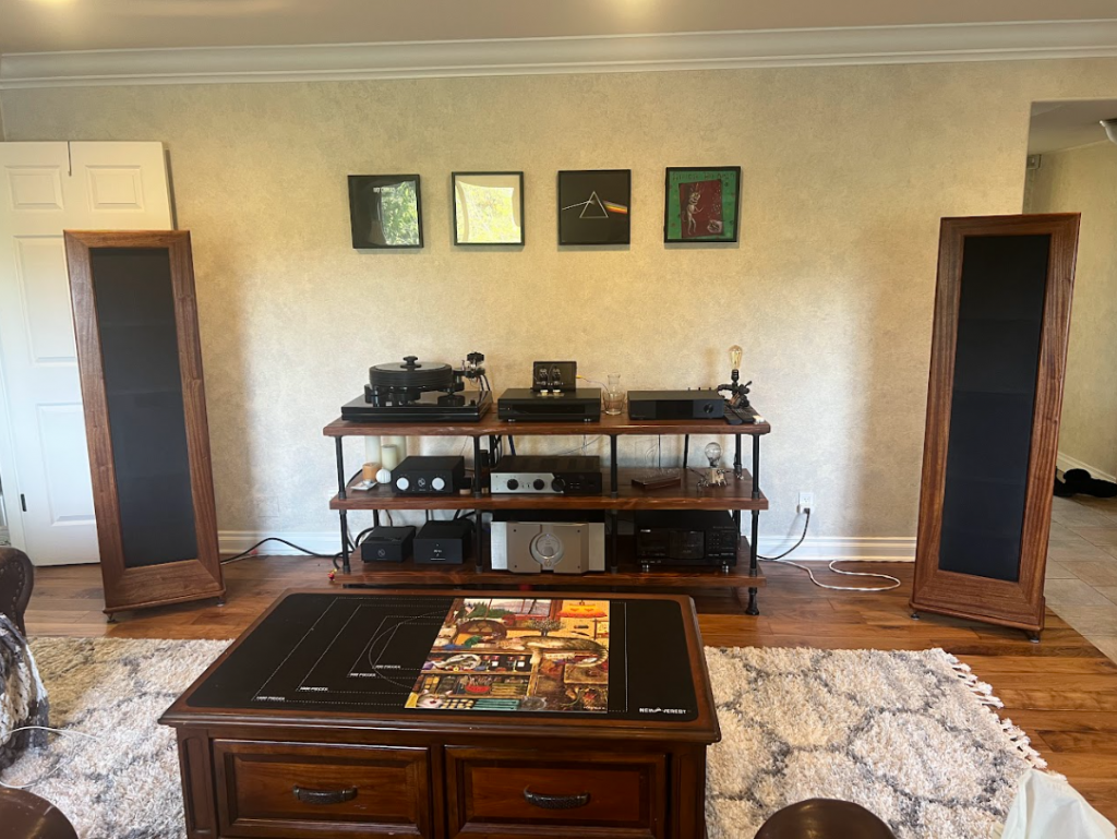

I own a pair of Peter Gunn modified Magnestands. I have enjoyed them, as is, for years, but I am now looking to add subwoofers to the system. based on budget, I initially thought I would just get a pair of Rythmik E15's and call it a day. However, after talking with Brian and doing some research I believe the GR research paper cone subs may be a better fit for the detailed sound of the Maggies.
This has created another set of issues. The amount of subs possibly needed (and price associated), the potential size of the subs if I build custom, and finally, pissing off the wife.  :lol:
The room is in an open floor plan, it is 3600cf, with no easy way to seal it off from the rest of the first floor (kitchen, den, hallway, staircase)
Based on the speakers and what I am trying to accomplish how would you all suggest I go about filling this room with bass and what subs / types would you add to the room and system?

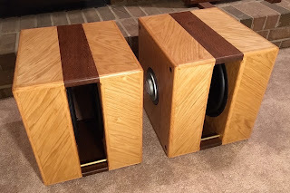

If you're happy with your Maggie's down to 100Hz, you might want to consider a pair of RiPol (dipolar) subs like mine.   There are commercial versions available, most notably from Modal Akustik in Germany ($3,500 each-- ouch$$$).  Or, if you're a DIY type, build a pair like mine shown below.
If you're interested, PM me and I will send you my drawing, parts list and build tips at no charge.
Here's a link to the RiPol sub build page on my website:  https://jazzman-esl-page.blogspot.com/2011/01/ripole-subs-are-underway.html

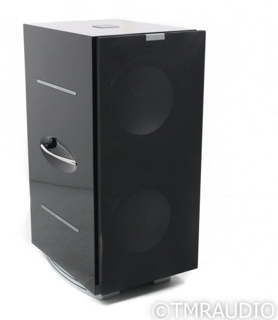

The Music Room has a used REL Acoustics 212/SX Dual 12 for $3,299. I have bought items from TMR a few times, they are a A++ reseller, delivery is fast and packaging is bullet proof. A single 212/SX Dual would easily pressurize your room when called for. And it's not ugly.
https://tmraudio.com/fresh-arrivals/rel-acoustics-212-sx-dual-12-powered-subwoofer-piano-black-mkqo/
REL's John Hunter describes the REL Acoustics 212/SX Dual 12
https://www.youtube.com/watch?v=_E5__nt-3zU
